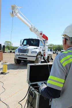

    Two types of dielectric tests must be performed on insulated aerial devices and digger derricks: the qualification and periodic tests. The qualification test is required to determine the voltage rating of the unit. The periodic test (Photo 1) is done at intervals to verify that the equipment continues to provide the expected insulation. Knowing who is responsible for these tests and when to perform them is essential to identify any defects or weaknesses in the insulation capabilities of the equipment. Once in use, the responsibility falls on the owners and users.

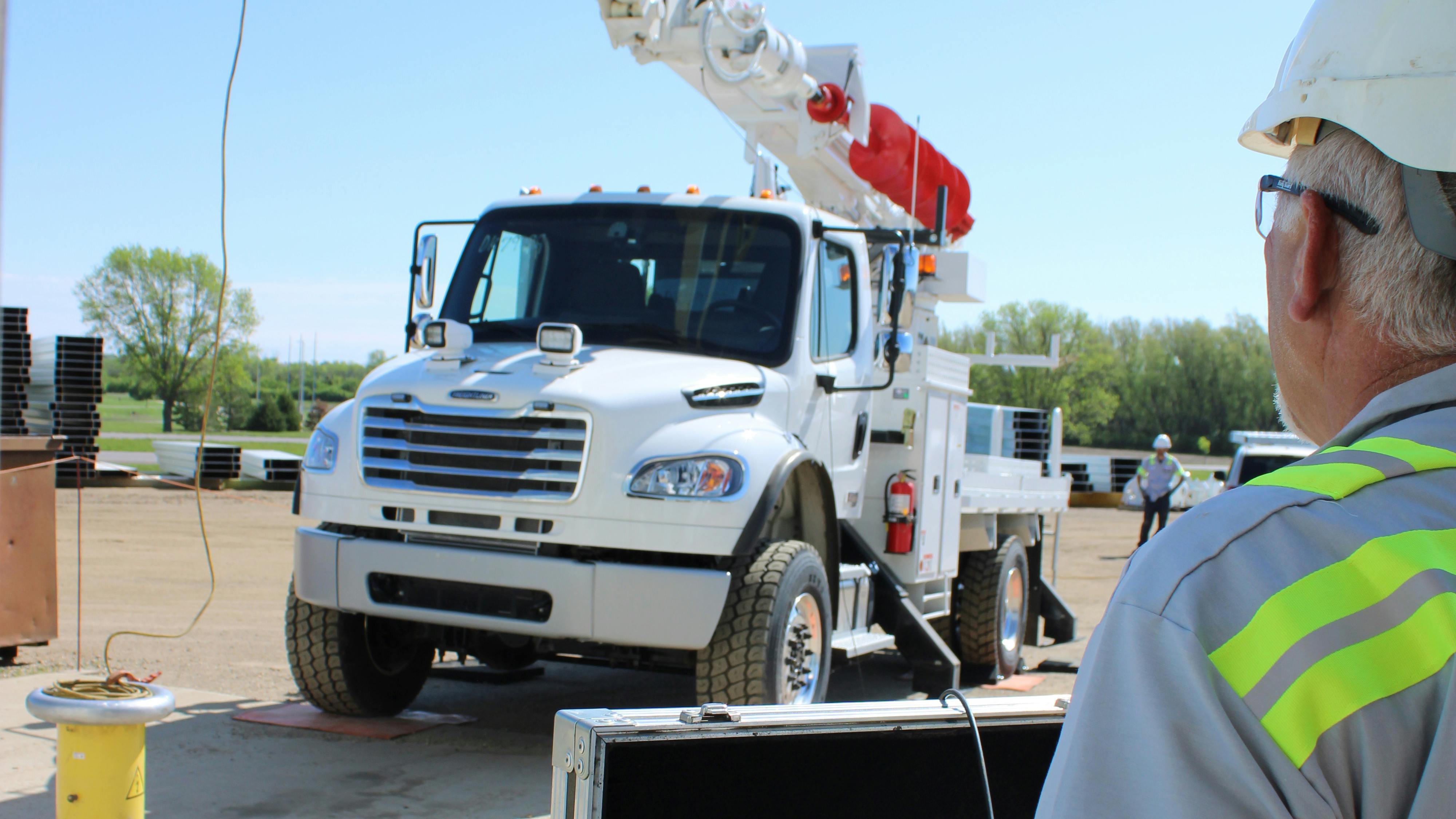

    New insulated bucket trucks or digger derricks are first tested by the OEM (Photo 2), according to ANSI A92.2-5.3.2 or A10.31 5.3.2 requirements, respectively. This qualification test at the factory establishes the insulation rating for the equipment. The installer will then perform a dielectric test to confirm the insulation after the units are finished and operational. A qualification test is also required if the fiberglass boom is replaced. Then, the original qualification test is no longer valid.

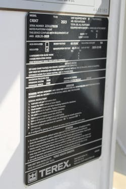

    Before conducting any type of dielectric testing, you should first know the machine’s voltage rating and category. Refer to the voltage ratings for the equipment. The ID plate (Photo 3) on your bucket truck or derrick will indicate if the unit is insulated and, if so, the voltage and category the insulation is designed and tested to withstand. The equipment manuals tell what areas of the machine will provide insulation.
    Look on the ID plate for the “qualification voltage.” The number in this area is the voltage rating the unit was tested and qualified for per ANSI standards. The date of the qualification test is indicated on the ID plate as the “test date.”
    There may be two voltages stamped on the ID plate near the lower controls. The qualification voltage is the most important. The design voltage may not be shown on the ID plate and is the maximum voltage for which this machine can be rated if it is properly equipped and tested. The machine cannot be used on lines at the design voltage unless the qualification voltage indicates the same voltage on the ID plate.
    Qualification voltage is the maximum voltage for which the upper boom on aerial devices has been tested and rated. The same is true for digger derricks, which can be used as an aerial lift when equipped with a platform and upper controls to work on power lines. For digger derricks, the fiberglass boom must be fully extended, and the load line removed across the insulating section to provide this insulation. If used with a platform, the operation must be controlled by the person on the platform to work on energized lines or equipment. Digger derricks cannot be used with a platform attached unless the ID plate indicates a platform capacity, because it is not designed and tested for platform use.
    Insulated equipment can be used to work near electrical system lines up to this phase-to-phase voltage if the proper personnel protective equipment (PPE) and procedures are used. The insulation provided by the booms is secondary to PPE. Only Category A units (when used following bare-hand work procedures) will provide primary protection. The ratings are given as the phase-to-phase voltage of the system. The booms are tested based on the phase-to-ground voltage, not the voltage between the phase lines. A 46kV-rated unit cannot be used on a 69kV system even though the phase-to-ground voltage of the 69kV system is less than 46kV.

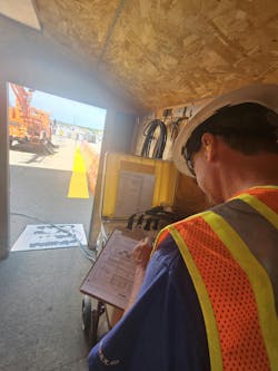

    Qualification testing (Photo 4) can only be done with an AC testing machine. This is performed by qualified service personnel. It is performed anytime the fiberglass boom section is modified or replaced. A record of dielectric tests should be maintained in written, dated, and signed form.
    After the aerial device or digger derrick is installed on the chassis, one of the following dielectric tests is required to be performed by the installer. They can conduct another qualification test with AC equipment, or if the installer accepts the qualification test from the manufacturer, they can perform a periodic test using AC or DC test equipment. In the case of boom replacement, the OEM tests the boom before shipment, but this is not considered a qualification test because the unit must be fully assembled and operational with all components installed in the insulated section. The entity reassembling the unit must perform a qualification test before the unit can be returned to service.

    A periodic test is necessary whenever there is a question of the dielectric properties, such as contaminated or deteriorated fiberglass. This type of test must also be done anytime repairs have been made to components that cross the insulating section. An example is when boom hoses or leveling rods are replaced. A periodic test can be performed with either AC or DC testing machines.
    Boom positions should be recorded when performing dielectric tests, as the position can cause readings to vary, especially for AC tests. Testing the boom in the same position each time will give more consistent readings. By comparing the test results from year to year, any trend upward in leakage current may aid in determining if the fiberglass boom's insulating properties are deteriorating and if the fiberglass, hoses, or leveling rods need to be inspected or repaired.
    Finally, as stated previously, an annual test must be performed. AC or DC testing can be used. Either a qualification test or a periodic test will suffice for meeting the Annual Test requirement.
