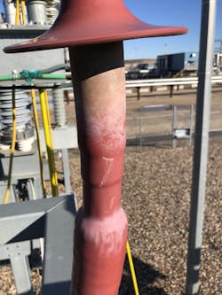

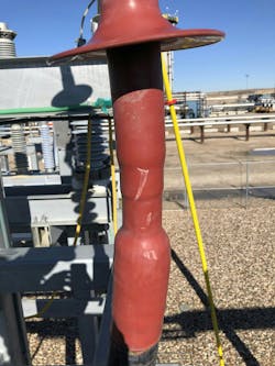

A high-voltage asset owner in central Canada had numerous terminations on substation structures. Contamination was building up unevenly on their terminations. This operator was very proactive and periodically did PD surveys of indoor and outdoor assets as part of their regular preventative maintenance.
One of the scanned terminations returned very high levels of ultrasonic energy. The phase-resolved plots showed typical PD results. The source was frequency-locked to the power system, and the impulses occurred twice a cycle, half a cycle apart. The levels were approaching 40 dBuV, which is very high. ANSI/NETA MTS 2019 calls for immediate action on levels greater than 6 dBuV. Figure 7a and Fig. 7b show the phase-resolved plot and the contaminated termination.
During the next scheduled outage, the insulators were cleaned and then rescanned. The ultrasonic energy was gone, proving that the discharge was a result of the contamination. Figure 8a and Fig. 8b show the phase-resolved plot and termination after thorough cleaning.
