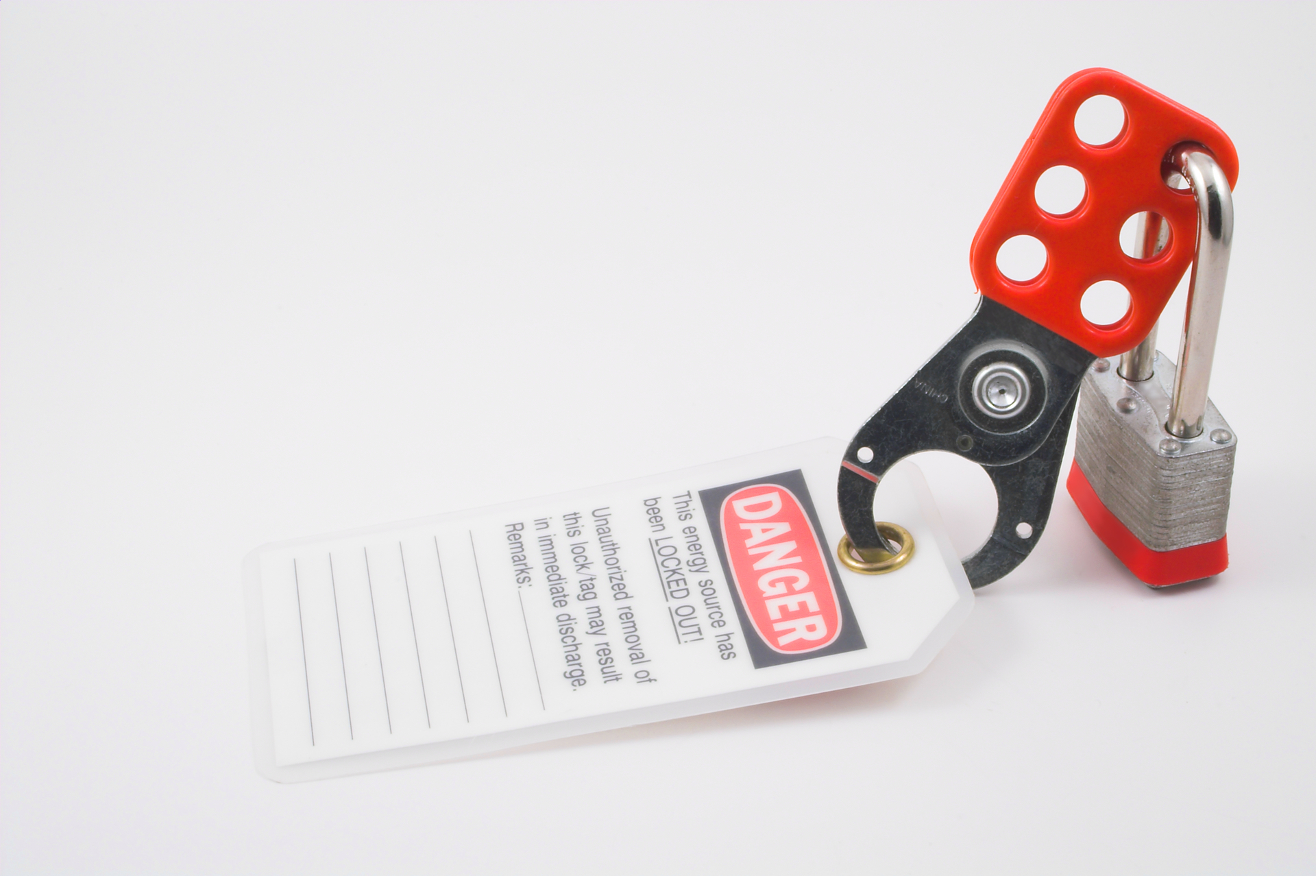

    You must establish an electrically safe work condition through lockout/tagout. There is no other way, so NFPA 70E, Art. 120 “Establishing an Electrically Safe Work Condition” is all about lockout/tagout. The employee performing the work also performs the lockout/tagout. But the employer has specific responsibilities to ensure that job gets done right every time. Those responsibilities are in Sec. 120.1(B):
    1. Provide the equipment necessary to execute lockout/tagout procedures. This means it’s the employer — not the employee — who buys the locks and tags. Since proper execution also requires a means to verify the absence of voltage, the employer is also required to provide test equipment that can reliably verify the absence of voltage. The ability to verify the absence also means the ability to verify the presence, so the equipment must be properly maintained at the employer’s expense.
