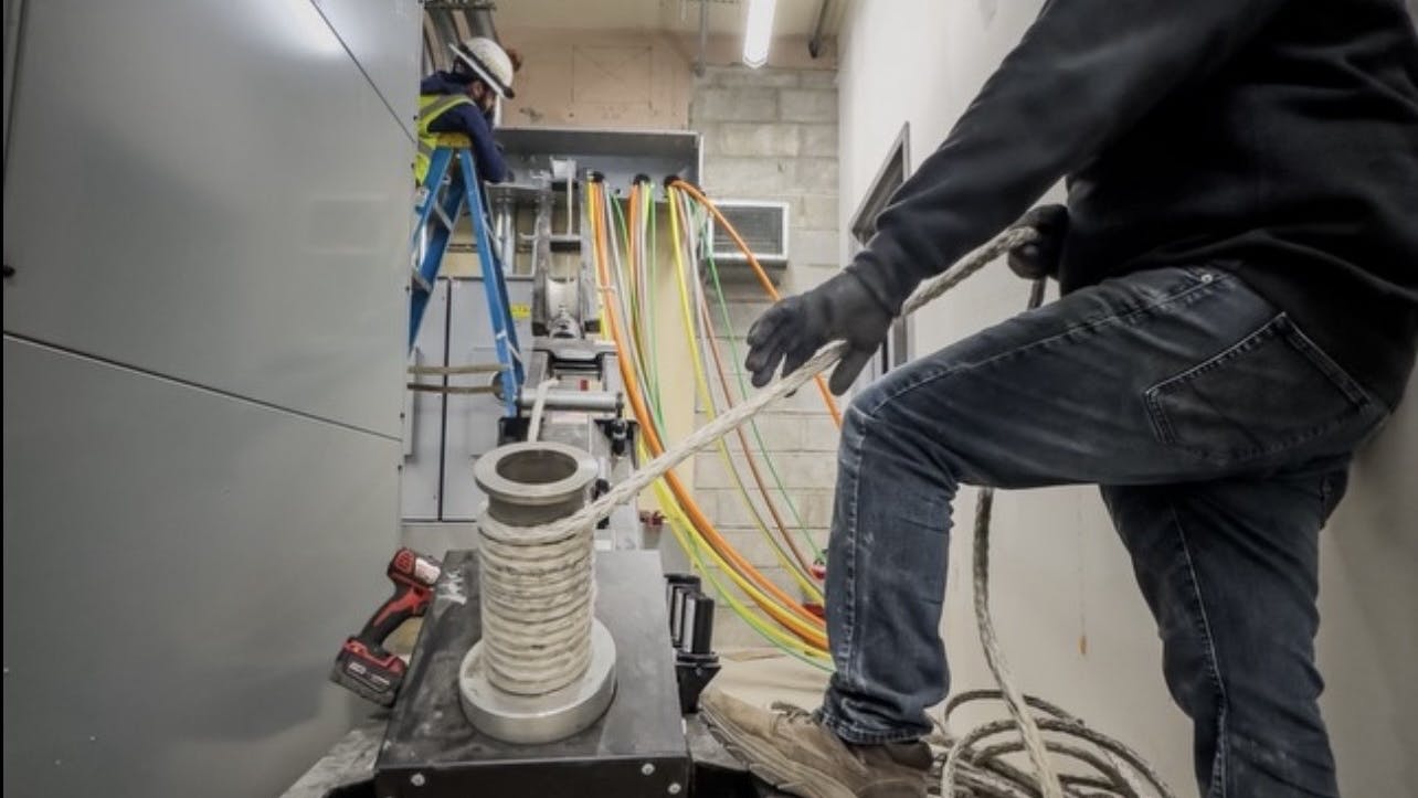

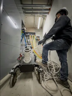

Preplan cable pulls
Pulling devices and conductors have high allowable tension ratings; however, structural support limitations and maximum sidewall bearing pressure can often reduce the allowable tension on these pulls. Cable-pulling software can help contractors account for those tension limitations and plan accordingly. Though not required by regulation, software tools like this add a critical layer to worksite safety.
Use manufacturer-installed pulling heads
Most cables do not come with pulling heads attached, requiring workers to add them on site. This involves the use of a knife, which could result in injury. Another drawback is that the field-made wire head may not fit in the conduit or around a tight turn. In addition, approximately 3 feet of cable is wasted on every phase of an install. Using cut-to-length cables with manufacturer-installed pulling heads, contractors are assured that the cable will always fit, safety risks are minimized, and waste and cleanup labor are minimized.
Use low-friction pulling ropes and foot triggers
Low-friction ropes reduce the risk of snapping due to excessive force or friction, and using low-absorbency ropes helps prevent water absorption and rot. Implementing these safety standards across all projects ensures that crews are not operating with a false sense of security, enhancing overall job-site safety.

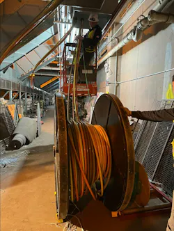

For example, by utilizing innovative packaging solutions from manufacturers that ease material handling, electrical contractors can reduce the physical effort normally needed to position larger reels for pulling or pulling smaller wires out of packaging. Adopting these packaging solutions would involve moving away from spools on circuit wiring and instead leveraging coils enclosed in a plastic shell. For larger gauge wires, contractors can procure exact lengths and configurations on an easily movable piece of reusable reel-like equipment, which aids in minimizing waste by reducing the amount of scrap reels.
