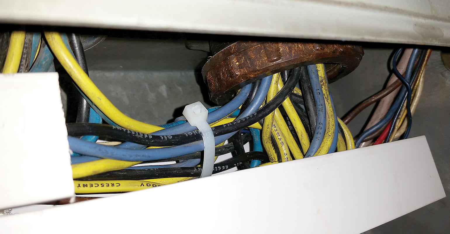

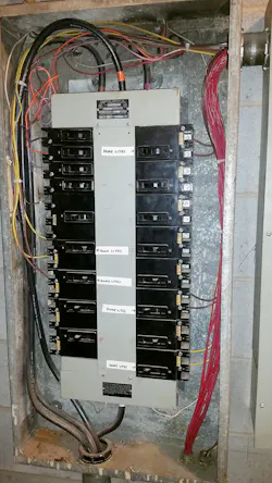

The Figure above illustrates a typical installation in an older facility where 480V lighting branch circuits were originally installed to power a traditional HID-based lighting system. When a new electronic lighting control system was installed, it was grounded to the lighting distribution panel (LDP), which was part of the original installation. The LDP uses no grounding conductor back to the main switchgear. The LDP relies on established ground from a nearby cold copper water pipe. A ground conductor does exist from the LDP to the lighting control panel. However, no EGCs exist from the lighting branch circuit pull box (Photo 1) to the individual junction boxes mounted on the ceiling.
With this installation, the LED luminaires have to rely on the “grounded” electrical metallic conduit (EMT) system, which provides protection for the AC lighting branch circuits. The system is bonded to the lighting branch circuit pull box. However, EMT contains many mechanical joints. These joints rely on EMT fittings, which use compression rings and set screws to mechanically secure them in place. These joints do not establish a low-impedance bond between individual sections of EMT. The joints and fittings also do not establish a low-impedance connection with the lighting pull box or the lighting control panel. Regardless of how good the bond to the cold copper water pipe is, the impedance the LED luminaires see back to Earth is very poor.
