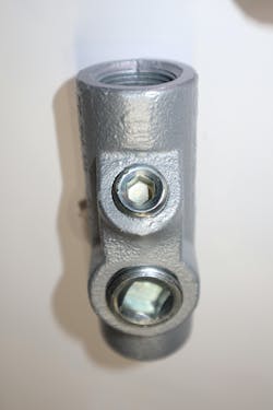

A conduit seal fitting is used in electrical conduit runs to prevent the passage of gases, vapors, or flames through the conduit. To work effectively, always follow the manufacturer’s instructions when pouring sealing compound into the fitting. Seal location requirements are found in Sec. 501.15 [Sealing and Drainage], as shown in Fig. 5a and 5b.
