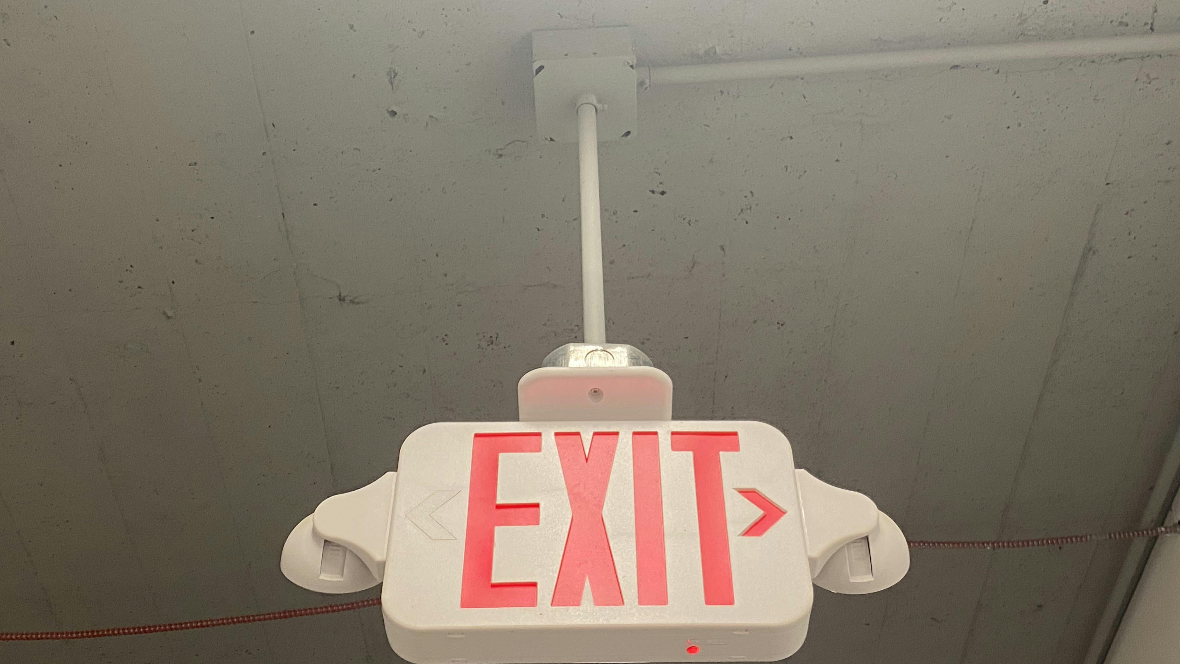

What’s Wrong Here? Hint: Sketchy Use of EMT
Hint: Sketchy use of EMT.
Neither EMT nor EMT connectors are designed or listed for supporting the weight of an exit sign! If the installer who did this work stopped and thought about what was really supporting the weight of this dangling equipment, he or she may have realized that the setscrew connectors and the locknuts are being asked to preform functions they are not really not designed for. They are supporting all the weight of the exit sign, the battery inside the exit sign, the wires, and even the 4-inch octagonal box on which the exit sign is mounted.
Section 358.12(2) prohibits using EMT “for the support of luminaires or other equipment except conduit bodies no larger than the trade size of the tubing.” Installing anchors in the ceiling and using threaded rod to support the exit sign would be one relatively easy fix to provide a Code-compliant installation here. The dangling EMT is also not properly secured and supported as required by Sec. 358.30.
