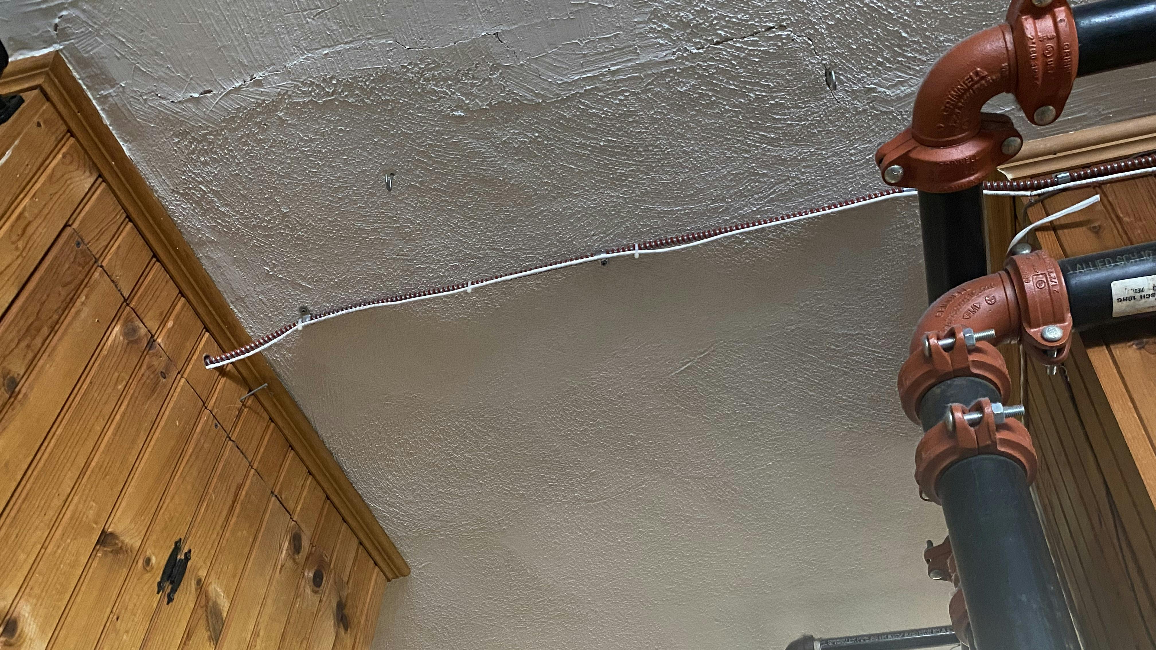

Hint: A surprise on the ceiling.
I spotted this wiring on the ceiling of a clothing store where my wife and I were shopping. There is an MC cable clipped to the ceiling with a white-colored Class 2 cable secured to the MC cable.
Section 300.11(D) seems pretty straightforward with the wording “cable wiring methods shall not be used as a means of support for other cables, raceways, or nonelectrical equipment.” Apparently, the installer of this wiring did not remember Sec. 300.11(D) or simply chose to ignore it. Or perhaps the installer thought Sec. 300.11(D) did not apply to the Class 2 cable since Sec. 722.3 states in part, “only those sections of Art. 300 referenced in this article shall apply,” and Sections 722.3(A) through (O) make no mention of Sec. 300.11.
In this case the installer missed the last sentence of Sec. 722.24(A) which states “the installation shall conform to Sec. 300.4 and 300.11.” The original MC cable installation seems Code-compliant, but once the Class 2 cable got secured to the MC cable, that was when the violations occurred.
