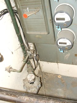

How well do you know the Code? Think you can spot violations the original installer either ignored or couldn’t identify? Here's your chance to moonlight as an electrical inspector and second-guess someone else's work from the safety of your living room or office. Can you identify the specific Code violation(s) in this photo? Note: Submitted comments must include specific references from the 2020 NEC.
Hint: You have no standing.

February Winners
Unfortunately, there were no winners this month. It appears the violation was not as plain as black and white.
This may appear to be three white wires installed in the service raceway, but, in fact, there is only one white wire. One ungrounded conductor has red insulation, and the other ungrounded conductor has blue insulation. Unfortunately, the damaging rays of the sunlight have caused severe fading of both the red and blue insulation. I was only able to make this determination when I opened the meter socket enclosure and noticed the red, white, and blue wires.
Section 310.10(D) requires that conductors or cables exposed to direct sunlight be listed as sunlight resistant, or the cables and conductors must be covered with an insulating tape or sleeve that is listed as being sunlight resistant.
