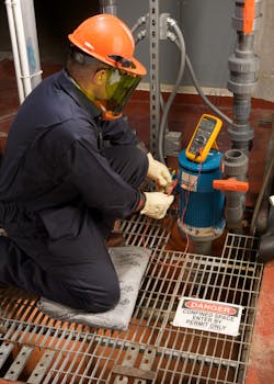

  • If the motor fails to start, check the voltage at the motor terminals using the voltmeter setting on your multimeter. (Be sure to use a meter with the proper safety rating for the task). The voltage reading should be within 10% of the voltage listed on the motor nameplate. If the voltage is incorrect, then troubleshoot the circuit to the motor (Photo 1). If the voltage is correct, turn OFF power to the motor so you can test the motor.

  • Using a multimeter, measure the voltage at the motor terminals to make sure the power is OFF (Photo 2).
