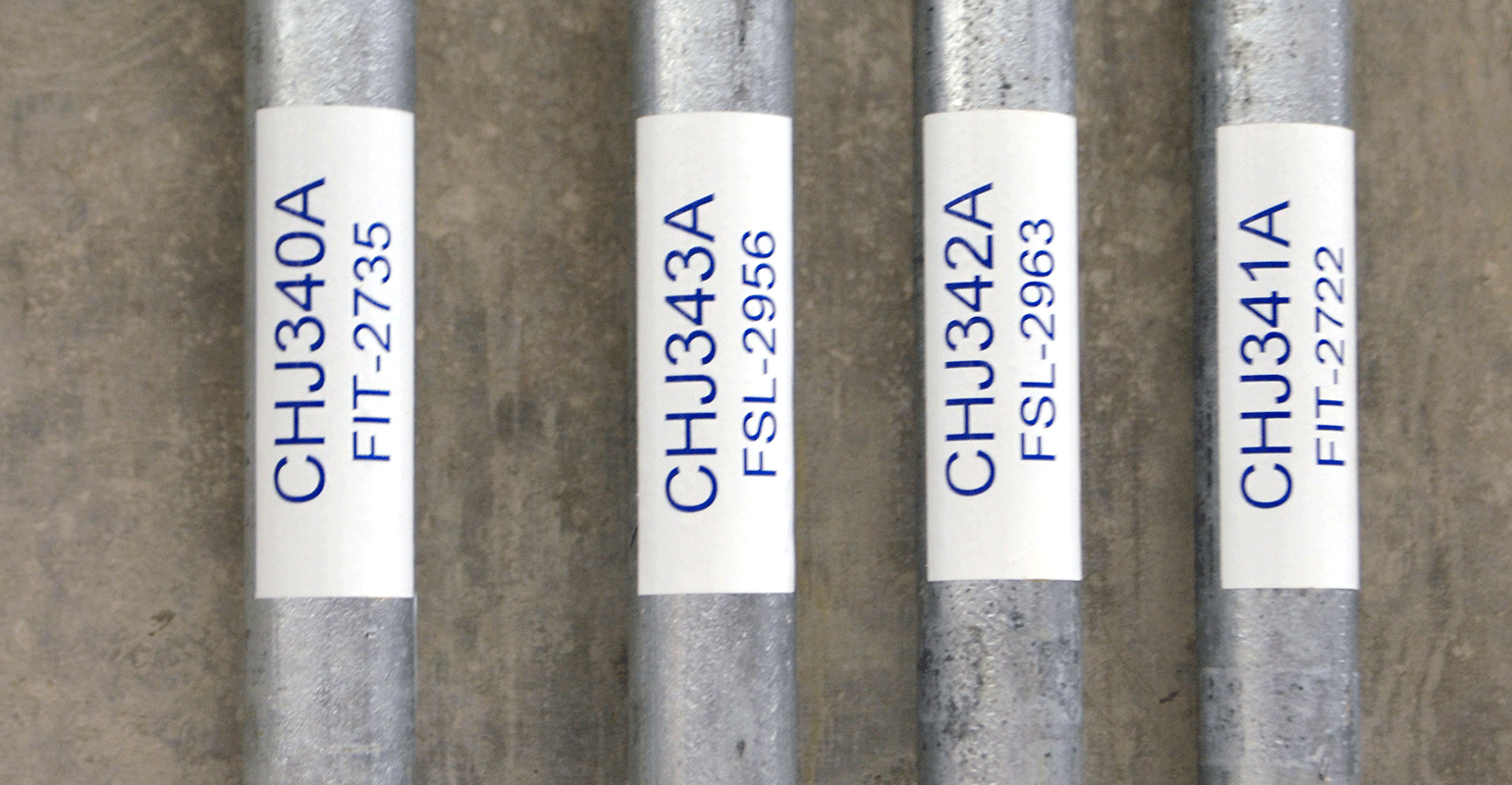

It’s a good idea to label electrical conduit with the voltage, an ID number, and the locations the conduit connects from and to. Labels should be placed at both ends of the conduit, at junction boxes, and any other location where information about the wiring in the conduit might be needed.
Several labels may be used to supply all the needed information. For example, an orange warning label with the text “480V” might be used. An arrow may be used to indicate the direction of power flow from the source to the point where the power is distributed or used.
A second label, white in color, may be used to identify the purpose, source, and destination of the conduit. The label with the voltage is orange because it is a safety-related label informing the reader about the voltage hazard. The second label is white because it is an informational label.
