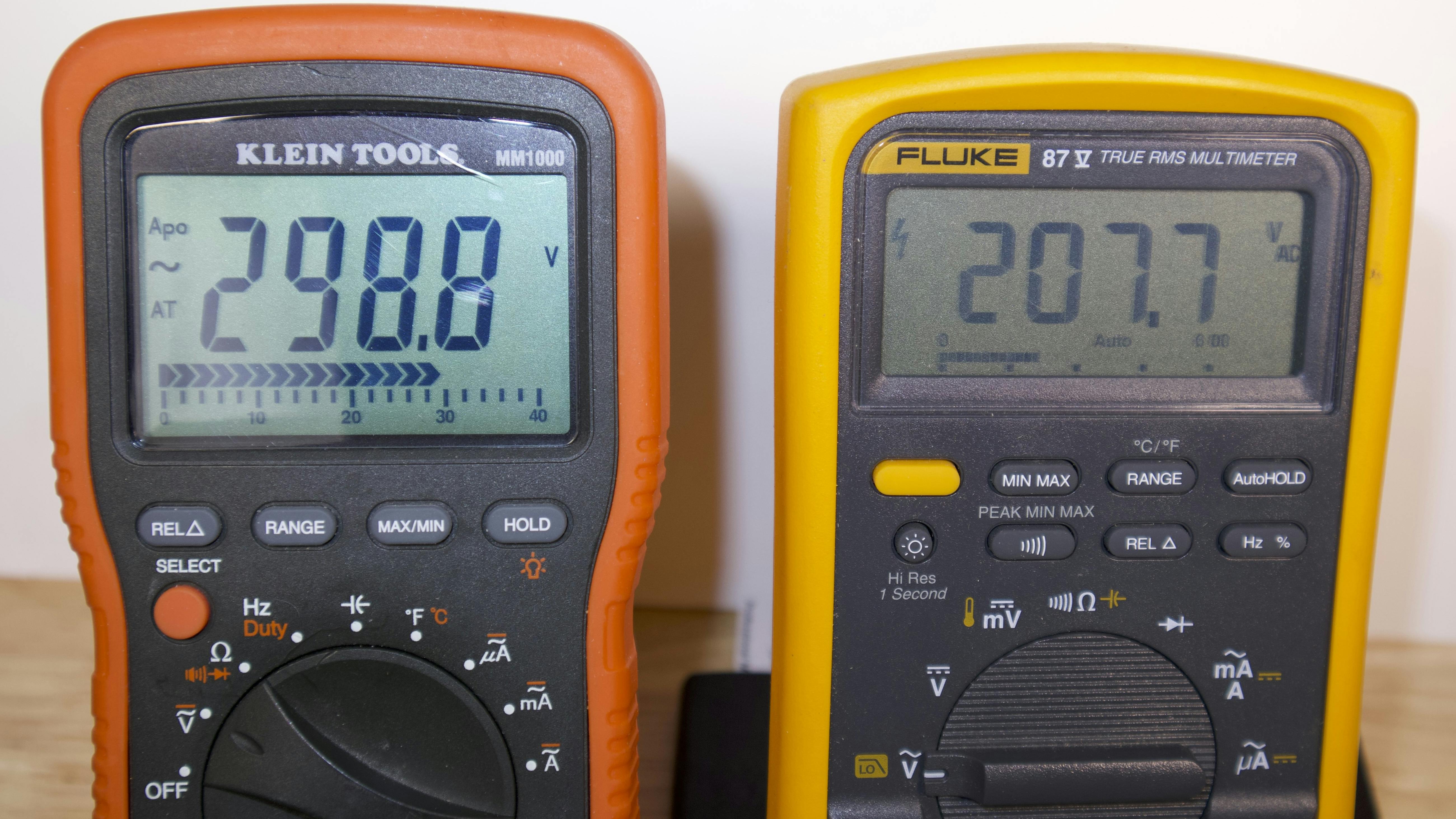

Reading voltage values in electronic circuits, such as variable-frequency drives (VFDs), uninterruptible power supply (UPS) systems, battery chargers, and any distribution system supplying significant electronic loads, requires the use of a “true-rms” meter rather than an “average-responding” DMM. An average responding meter reads the root mean square value (rms) of a pure sine wave. Due to the countless electronic devices in distribution systems today, many such systems are made up of distorted sine waves. These distorted waves can produce voltage readings as much as 40% low and high on average responding DMMs. Electronic loads produce high-frequency noise and harmonics that distort the non-sinusoidal readings. Low-pass filters are designed into DMMs to block high-frequency noise. Use the correct type of DMM on these circuits, or expect inaccurate readings (Photo 1).
