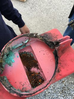

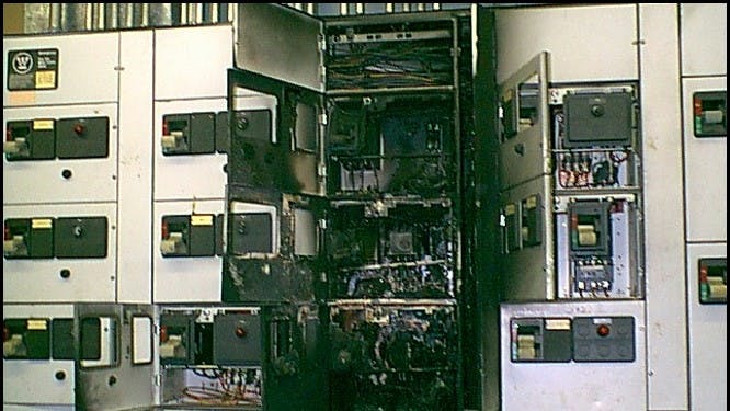

One of my earliest lessons in the importance of thermographic surveys occurred at a hotel. As a young technician and newly certified thermographer, my assignment was to perform an IR survey on equipment as directed by the client. Things went well as we scanned all the primary service entrance equipment and other portions of the power systems that the client felt were critical. Unfortunately, what was deemed critical didn’t include a motor control center (MCC) in the penthouse. Fast forward a few short weeks to when the hotel suffered a failure in that same MCC.
This failure not only destroyed the bucket (Photo 1), which had a loose connection, but it also created an arc fault that burned bus work inside the gear in half, thereby rendering the entire MCC unsalvageable.
At this point, the criticality of the gear became glaringly obvious. This MCC was the source of power for the hot-water heating system. Imagine the difficulty created when an entire hotel of guests had no hot water for their morning showers. It created a difficult conversation for myself and the facility engineer. We both learned a valuable lesson. Never leave a job site until every reasonable attempt has been made to scan everything inside the facility.

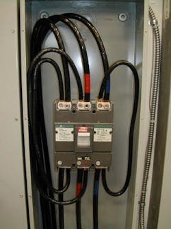

A second benefit of thermographic inspections is that other safety hazards and National Electrical Code (NEC) violations can be found even in equipment without a thermographic issue. For example, a fuse that is replaced with a short section of copper pipe or a set of jumpers installed (Photo 2) by a well-intentioned, but reckless, electrical contractor can create a major safety issue.
Yes, that picture was taken inside a facility; it was not staged. After immediately bringing this to our customer’s attention, we heard a story of how this particular breaker had been tripping repeatedly, causing unacceptable outages. The fix, which I’m sure was never openly discussed, was to install jumpers from line to load and effectively eliminate the breaker. This has been a powerful lesson as to the importance of always testing for the absence of voltage after opening a breaker and before beginning work.

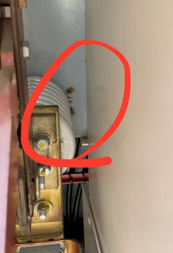

In both cases, our troubleshooting attention turned to the main switchboard. We tested the gear to confirm it was on the gear side. It was. Initial inspection revealed no evidence for the low reading, so we began the work of taking things apart. All of this time and work to isolate the issue now paid off as boots were removed and stand offs were unbolted from bus work to reveal partial discharge and corona damage (Photo 3Photo 4, and Photo 5). One simple test — and the tenacity to chase down a failing reading — headed off a potentially catastrophic failure.
While all test results might pass on this switch, a qualified technician would recognize this as evidence of partial discharge, which is often related to moisture building up in the switch and typically is directly related to the failure of the space heater in the gear. Left uncorrected, this seemingly minor issue can cascade into violent failure. Be vigilant during your routine inspections.
