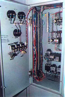

Here’s a true story. A job leader took an apprentice to a switchgear room where low- and high-voltage equipment was installed. He pointed out areas the apprentice was to avoid, such as the main incoming line compartment. He worked with the apprentice for some time cleaning low-voltage connection strips and the inside of the panels.
When the job leader was called away to another part of the job, he told the apprentice, “Don’t work on anything that looked hot,” and walked away. The apprentice continued to clean, tighten connections, and inspect the low-voltage control compartments. In each compartment, he used his voltmeter to determine whether the terminals were energized (Photo 1).
