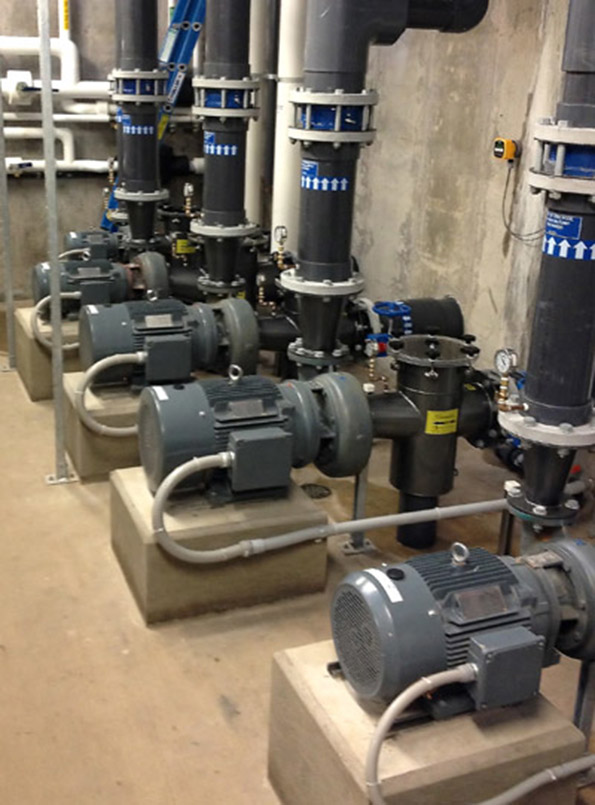

    Industrial motor installations often provide great opportunities for energy savings. The typical industrial motor lasts a long time — often several decades — so an investment in energy reduction can add up to serious money during the lifetime of the installation.
