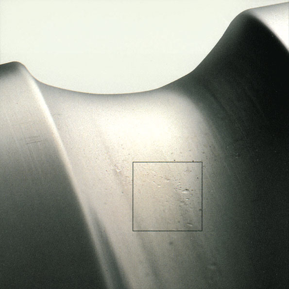

Among the electrical work electricians can do to reduce bearing failure, the following items are particularly important:
  • Eliminate motor grounding. This sounds counterintuitive, unless you understand the NEC definitions of grounding and bonding [Art. 100]. Grounding is a connection to the dirt. It’s crucial for lightning protection, but does nothing to eliminate the differences of potential that can cause current to flow through bearings.
  • Establish a robust bonding system for each motor system. This is what you do instead of driving a ground rod next to the motor. Remember, current does not follow the path of least resistance. We know, from Kirchoff’s Law, that current takes every path before it in inverse relationship to the impedances. Draw a circuit with two resistors, 100 ohms and 10 ohms, in parallel to refresh your memory on this one.
  • Conduct power quality analysis. Good bonding will reduce current through bearings to nearly zero, but you still want to reduce or eliminate that current at its source. Undesired high frequencies from power quality anomalies are especially problematic.
