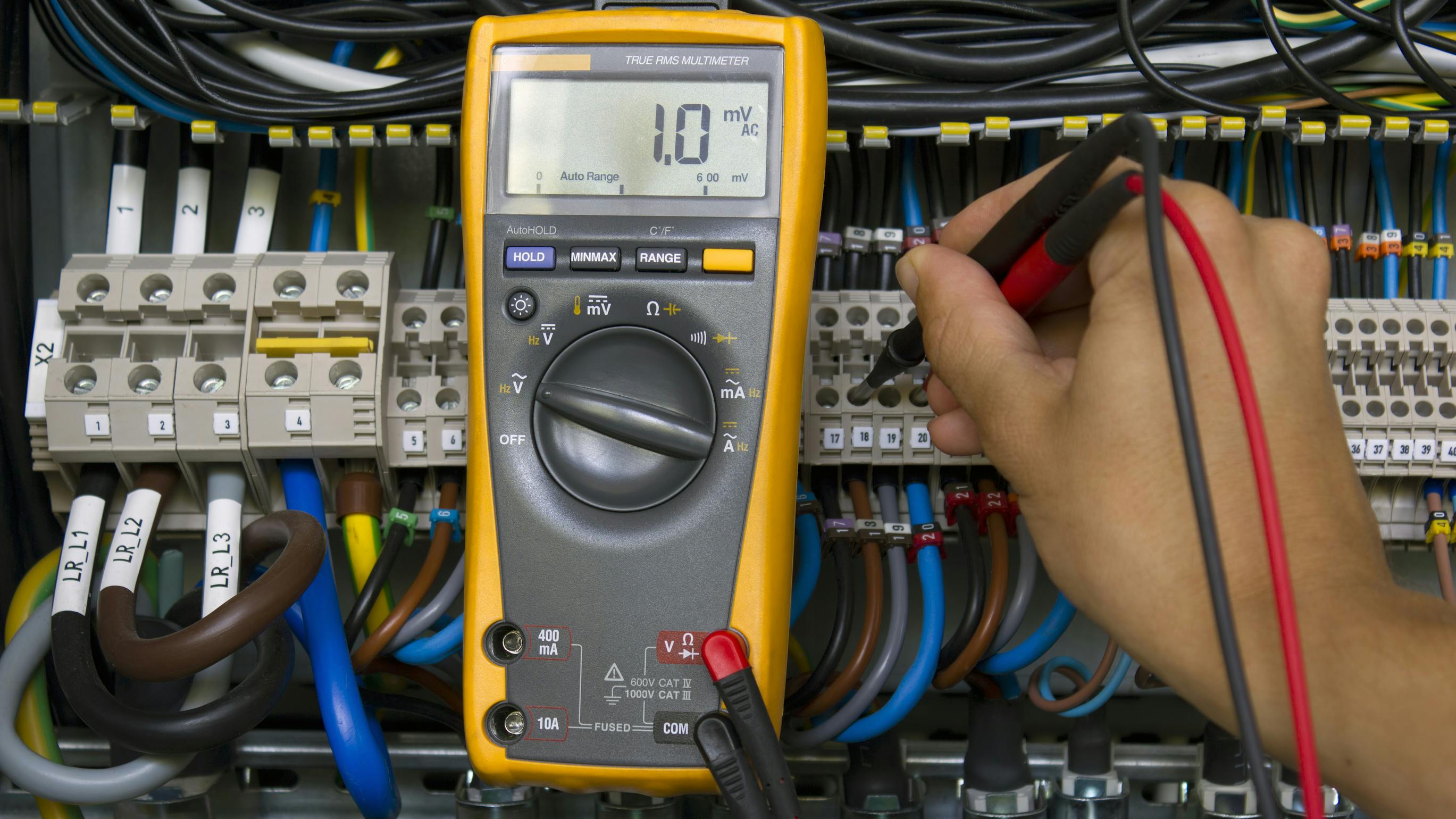

Digital multimeter best practices
Here are some tips for using a DMM correctly:
  • Know what measurements you need to take, what measurement points are best, and how to set the meter for those measurements.
  • Set the meter for the intended measurement before connecting it.
  • Don’t take measurements you don’t need to take.
  • Never use a DMM to directly take current measurements in a power distribution system. Use a current clamp with a DMM or use a meter designed for that purpose.
  • Know the expected voltage range rather than let Autorange find it for you. While
  • Autorange is perfectly safe in itself, there is an operational and safety need for you to know what voltage to expect before you connect the DMM.
  • Don’t use cheap imports. The name brands are built to rigorous safety standards, while cheap knockoffs are built to no safety standards
