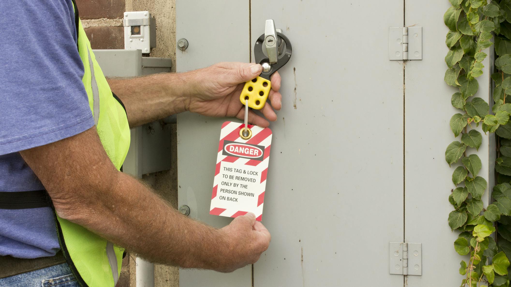

  • Use a digital multimeter (DMM) instead of a voltage pen for accurate power verification, and always follow proper lockout/tagout procedures.
