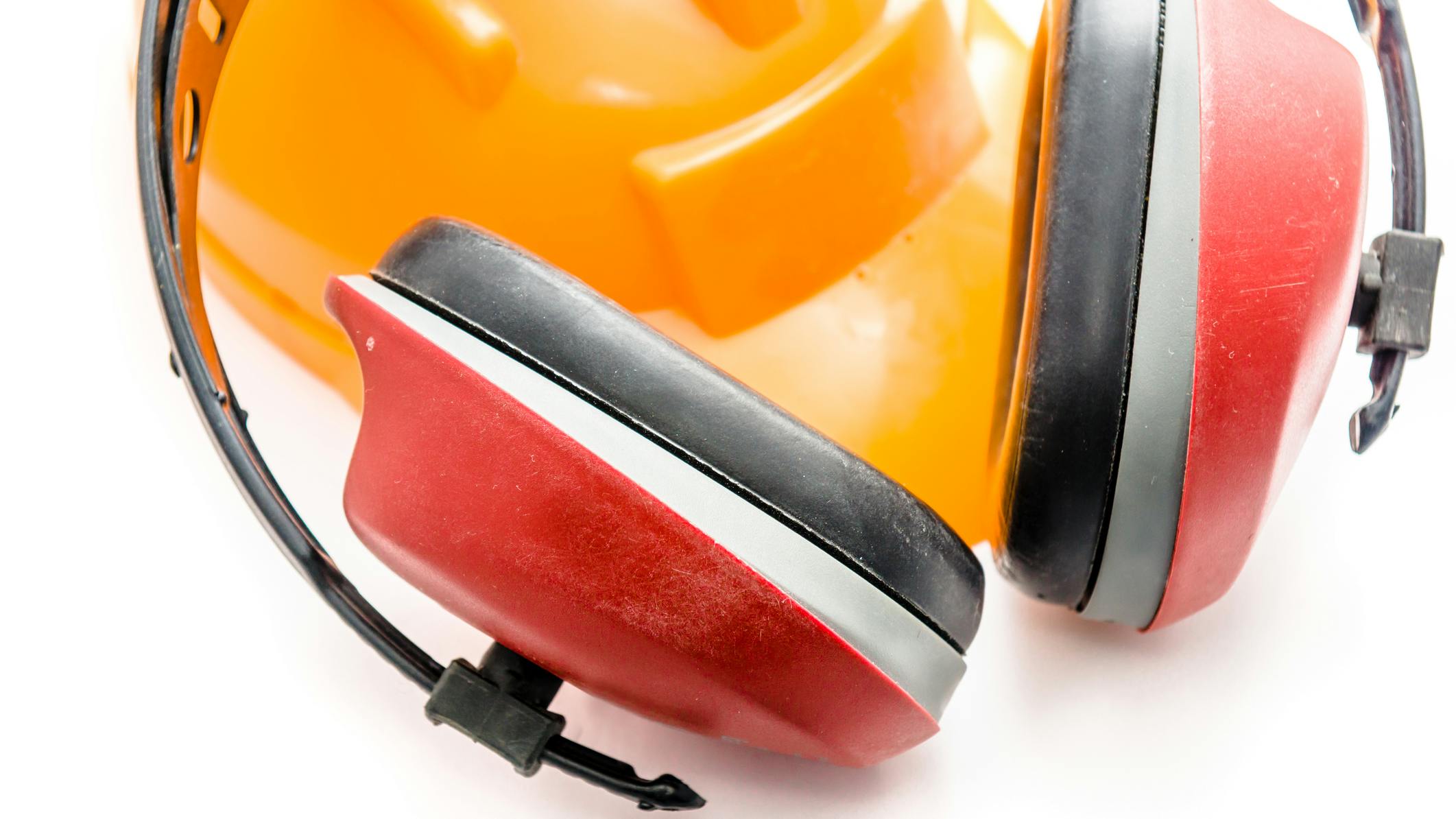

There are generally two options for hearing protection: earmuffs and earplugs.
Earmuffs are reusable and fit over the person’s head. They fit a range of different head sizes and can usually be adjusted to wrap around the person’s ears.
Earplugs can be disposable or reusable. The plugs slide into the person’s ears to block loud sounds from reaching the eardrum. They are usually made of foam or molded silicone that adheres to the shape of their ear canal. If the plugs are reusable, the material reverts to its original shape and is available for the next shift. Disposable plugs should retain their shape after they’ve been inserted into the ear canal. It’s not recommended to reuse them. They’re a good option if you don’t want to keep track of your earplugs between shifts.
Choosing between earplugs and earmuffs depends on several factors. Earmuffs can interfere with other types of safety equipment, including hard hats, goggles, and other electrical safety gear. In this situation, earplugs are the best choice because they fit inside the person’s ears.
Earplugs are also easier to carry around than earmuffs. They can fit inside a person’s pocket or tool bag without weighing them down in the field. This makes it easy for workers to put on their hearing protection equipment as needed throughout the day.
Earmuffs may be more effective if workers need to wear this equipment for the duration of their shift. Some workers also prefer the feel of earmuffs to earplugs because they may be more comfortable. However, they may also feel warm over time.
A contractor must also decide whether to utilize reusable or disposable hearing protection. Disposable earplugs are less expensive upfront and don’t have to be maintained over time. However, reusing equipment is more sustainable and can eventually save the company money if workers regularly clean and reuse them.
