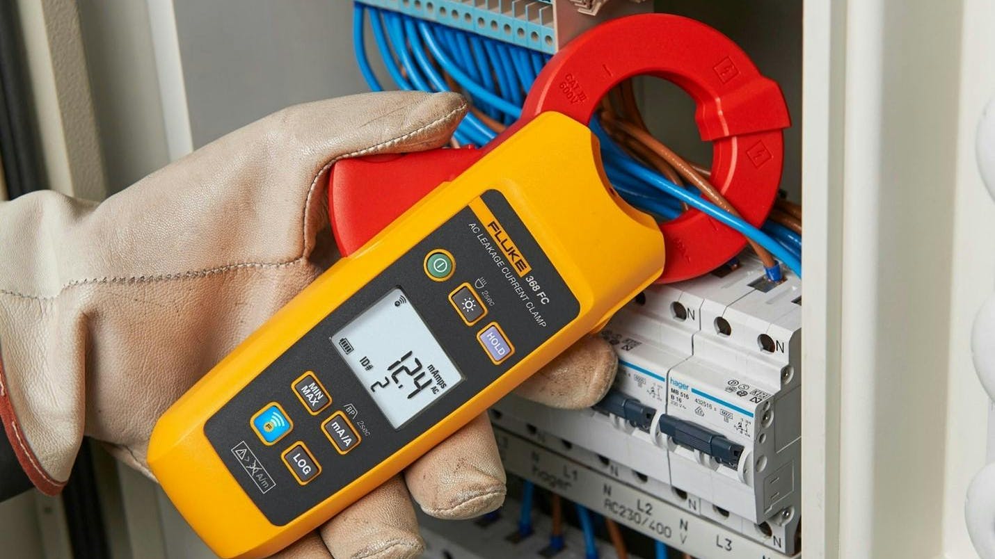

    Once you’ve double-checked everything, turn the power back on at the main breaker or fuse box. Use a voltage tester or multimeter to verify that everything is wired correctly and that there are no electrical leaks. While a small amount of leakage is normal, too much leakage can cause system interruptions or fires and can prevent equipment from running correctly. In extreme cases, it can cause a rise in voltage on accessible conductive parts. To test leakage, use a leakage clamp meter capable of reading less than 0.1 mA (Photo 3). Measure your circuit with all loads disconnected.
