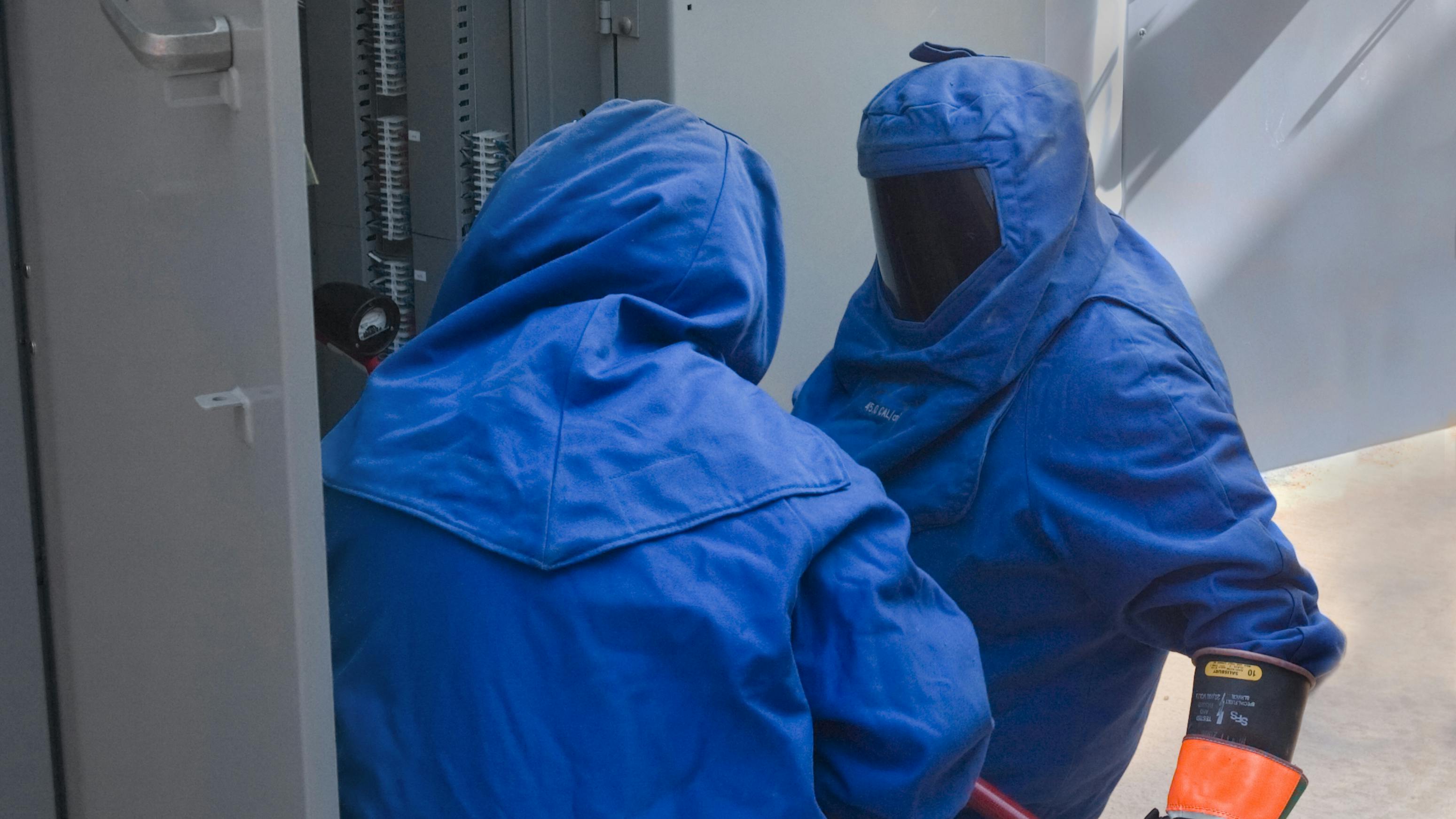

2. When do I have to wear arc flash PPE?
Arc flash PPE is required any time you’re inside the arc flash boundary. Any part of the body that is inside this boundary must be protected. According to Sec. 130.5(E), the arc flash boundary is the distance at which the incident energy equals 1.2 cal/cm2. The boundary distance can either be calculated or determined by Table 130.7(C)(15)(a) or Table 130.7(C)(15)(b) when the requirements of those tables apply.

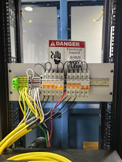

4. Do I need to wear voltage-rated gloves when using a digital multimeter (DMM)?
The context of this question is typically related to 120VAC nominal circuits. NFPA 70E defines “Working On (energized electrical conductors or circuit parts)” as “intentionally coming in contact with energized conductors or circuit parts with the hands, feet, or other body parts, with tools, probes, or with test equipment, regardless of the personal protective equipment (PPE) a person is wearing.”
NFPA 70E Sec. 130.4(G) states that any part of a qualified person’s body that crosses into the restricted approach boundary shall be insulated. Therefore, holding test probes that are in contact with the energized or potentially energized conductors is equivalent to contacting those energized conductors with your hands.
As per Sec. 130.7(C)(7)(a), “Employees shall wear rubber insulating gloves with protectors where there is a danger of hand injury from electric shock due to contact with energized electrical conductors or circuit parts.” If the qualified person’s hands, tools, probes, or test equipment cross into the restricted approach boundary of systems rated 50V or greater (AC or DC), then the use of voltage-rated gloves is required. This includes using a handheld meter to check voltages on 120VAC circuits.

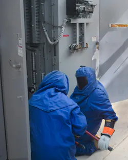

5. If the enclosure doors are closed, will this protect me from an arc flash?
This question is becoming less common than it used to be, but I still run across workers who believe if the breaker enclosure door is closed there is no need for arc flash PPE when operating a breaker. The only time that it is safe to operate a circuit breaker with no arc flash PPE on is if the risk assessment verifies there is no arc flash hazard — or the equipment is arc-rated, installed, and operated per the manufacturer’s instructions.
If the risk assessment verifies that there is an arc flash hazard potential, then the appropriate level of PPE must be worn to operate the breaker. Not only do the breaker enclosures have vents that will allow the super-heated air and gasses out of the enclosure, but arc flash events have also been shown to blow doors open, melt through metal barriers, and even strip bolts out of their holes to allow the pressure wave to escape — not to mention the common practice of only tightening enough of the latches/bolts to hold the enclosure/panel in place so that it is easier to remove on the next maintenance cycle, which is not an acceptable practice.
6. Do I need arc flash PPE if I am only operating electrical equipment?
This is very closely related to the last question. The difference is that the context of the previous question is someone who recognizes the potential for an arc flash hazard but has been led to believe that having the enclosure doors or panels closed will be able to contain the hazard. The context of this question usually relates to someone who doesn’t even really recognize the potential for an arc flash hazard. These are often operations personnel who are just simply turning 480VAC breakers on and off as part of their operations procedures. They aren’t opening any enclosures, exposing any conductors, or doing any maintenance, so they see this task as normal and not hazardous. However, as previously mentioned, the only time that it is safe to operate a circuit breaker with no arc flash PPE on is if the risk assessment verifies there is no arc flash hazard or the equipment is arc-rated, installed, and operated per the manufacturer’s instructions. If the risk assessment verifies that there is an arc flash hazard potential, then the appropriate level of PPE must be worn to operate the breaker.

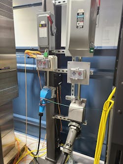

7. When do I need to use voltage-rated tools?
Voltage-rated tools are required to be used when working inside the restricted approach boundary of conductors that are not in an electrically safe work condition. Working inside the restricted approach boundary for non-diagnostic tasks also requires an EEWP. A task that would require voltage-rated tools also requires an EEWP, meaning that the worker should have an approved EEWP before performing any task that requires the use of voltage-rated tools. If the EEWP and hazard risk assessment process results in verifying that the task is infeasible to complete in an electrically safe work condition, then any work performed inside the restricted approach boundary requires tools that are properly rated and insulated to the correct nominal voltage.

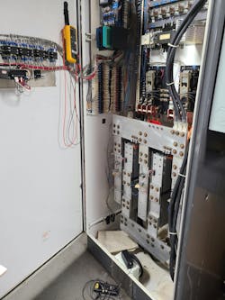

8. If equipment has no power coming to it, is it safe to work on/around exposed conductors with no PPE?
This question is typically a result of a lack of understanding of what steps are required to make electrical equipment safe. It is common to think that if you are within line-of-sight of a disconnect switch — and the switch is in the “open” position — then it must be safe to work on the downstream circuits. However, the only thing known when seeing a disconnect switch with the handle in the open/off position is that the handle has been moved to the open/off position. There is no guarantee what happened inside that switch enclosure. There have been plenty of incidents of mechanical failure inside the switch enclosure that resulted in one or more phases remaining connected when the handle has been moved to the open position.
Even if you disregard the probability of a component failure, typically when you begin to work on a task, a certain level of tunnel vision comes into play as you focus on what you’re doing. Someone may come along and have a reason to close that disconnect switch not realizing that someone is working on downstream equipment. Since you are focused on the task at hand, you may not recognize their move to close the switch in time to stop them or get out of any shock or arc flash boundaries before the circuit or circuit parts become energized. Just turning off the power does not make a circuit or circuit part safe.
The only approved means for establishing a scenario where no electrical PPE is required when interacting with circuits or circuit parts is to establish an electrically safe condition. It is essential that every electrical professional is proficient in this area. Review the answer in Question 3 to ensure you clearly understand the eight steps required in establishing an electrically safe work condition. Only after these steps have been taken can an exposed circuit or circuit part be considered safe to work on or around without the need for electrical PPE.

10. Can I layer two 20 cal/cm2 suits to achieve 40cal/cm2 protection?
Layering, concerning arc flash clothing ratings, is the idea of adding additional layers to increase the overall rating of the PPE as a whole. NFPA 70E uses the language of “layered system” or “clothing system” in the body of the standard. Informative Annex M, while not part of the requirements, provides some understanding of what is intended by using the word system in the context of layering. The Annex states, “Layering of arc-rated clothing is an effective approach to achieving the required arc rating when the layers have been tested together to determine the composite rating.” The only way to be certain that layers will increase the overall rating is if the layers were designed and tested to work together in a layered system.
If a worker is wearing 8 cal/cm2 pants, an 8 cal/cm2 undershirt, and a 12 cal/cm2 long-sleeve shirt (along with other required hand, foot, head, face, eye, and hearing protection), then the maximum arc flash energy the worker should be potentially exposed to would be 8 cal/cm2. The undershirt and long-sleeve shirt could not add up to 20 cal/cm2, and the exposure could not exceed 8 cal/cm2 because that is the maximum rating for which the whole body is protected due to the pants only being rated for 8 cal/cm2.
