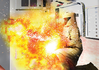

Photo 1. An arc flash can generate an electric arc with a temperature of 35,000ºF.

The tell-tale sound, flash of light, flames, and resulting smoke is the ultimate workplace nightmare: an arc flash incident. Something has gone wrong, and people and equipment are in danger. In simplest terms, an arc flash or arc fault occurs when electricity leaves its intended path and travels from one conductor to another or to ground (Photo 1). An arc flash can generate an electric arc with a temperature of 35,000°F, approximately four times the temperature of the sun’s surface. Equipment can start breaking up when an event exceeds 15 cal/cm2. The severity of an arc flash event is directly related to the available incident energy and the duration of the event.

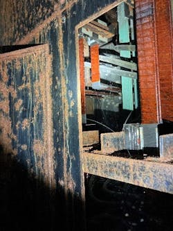

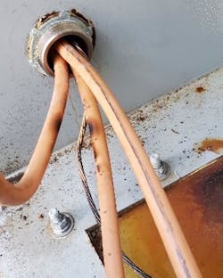

There are many causes of arc flash events. Often, they are driven by human error: the use of uninsulated tools during energized work, accidental contact with exposed live parts, and using damaged equipment. Some arc flash incidents are a direct result of the condition of the equipment, such as a loose connection, water intrusion, or worn/damaged insulation (Photo 2 and Photo 3). These items can often be identified during normal inspections — when, and if, they are performed.

Environmental factors are another issue that can plague mechanical devices (Photo 4). Contaminants, moisture, extreme temperatures (both hot and cold), and the atmosphere that the breaker operates in can all add to operational issues for a circuit breaker. Sometimes, these are obvious during an inspection, like a breaker covered in coal dust or current-carrying components that are blackened and damaged by hydrogen sulfide in a wastewater treatment plant. Environmental damage might be harder to spot, however. Rusted bearings deep within a mechanism or damaged contacts inside switches or relays may not be visible but can hinder the correct tripping of a breaker. Operational cycles on a circuit breaker are another consideration. A breaker that is used as a motor starter may have incurred enough operations to have worn mechanism components, internal parts, contacts, or weakened springs, making the device less effective at doing its job.

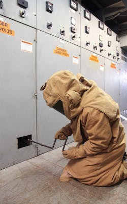

Qualified personnel are trained to use all information available to assess the risk when racking or operating a circuit breaker. The first step is often to review the arc flash label for that particular device. An arc flash label indicating the potential hazard doesn’t necessarily keep people completely safe from electrical dangers. However, the label provides a calculated arc flash hazard as well as arc flash boundary distance. These values are based on the premises that the equipment was properly installed/maintained, all doors and covers are closed and secured, and there are no signs of impending failure (Photo 5).
