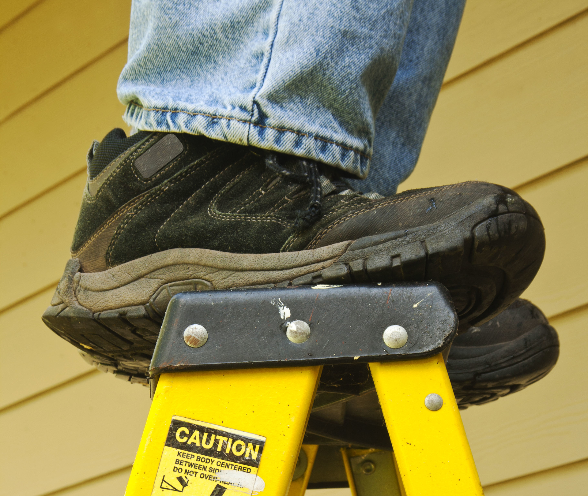

Danger 2: Compensation for short ladder
The fact that the ladder is too short is not the danger. The danger comes in when you attempt to compensate for that. Perhaps you stand above the final safe rung, or perhaps you set the ladder at too steep an angle for the desired height.
If the ladder is not extended far enough and can safely extend to the correct length for the application, then the solution is obvious. But if the ladder cannot be made long enough, you just have to use a longer ladder or perhaps erect scaffolding.
The short ladder problem typically arises when the job is not planned properly. Each elevation access point and each elevation must have an accurate height measurement recorded prior to the job planning. If it’s an off-site job, the service van needs to have the right ladder on it before heading off to the job site.
If Bill arrives on the job with an 18 ft extension ladder, only to find out the person who eyeballed the distance was shy a couple of feet, is he going to head back to the shop for the 24 ft ladder he should have had? We can hope so, but Bill should never be put in that position. He thinks about a round trip through what is now rush hour traffic. He looks at the ladder. He looks at the wall. He looks at his schedule. It’s only a couple of feet …
