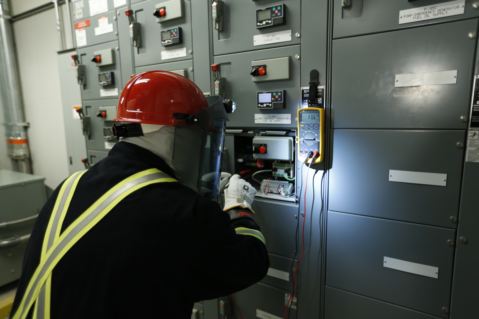

The most significant change in CSA Z462 2021 Edition relates to Clause 4.3.7.3.15 [Arc Flash PPE Category Method] (Photo below).The existing Table 6A arc-flash PPE categories for alternating current (AC) systems electrical equipment parameters were used with the new IEEE 1584 2018 Edition formulas and a new arc flash PPE Category 5, minimum 75 cal/cm2 is added for 600V class switchgear. In addition, the arc-resistant electrical equipment rows clarify that the arc flash PPE category is N/A when doors are closed and secured, and the available fault current does not exceed the arc-resistant rating of the electrical equipment. Table 6C [Personal Protective Equipment (PPE)] adds the new arc flash PPE Category 5 and quotes minimum 75 cal/cm2 ATPV arc-flash PPE.
A new alternate table to Table 6A, Table V.1 is also added in a new Annex V [Arc-Flash PPE Categories] that will be a normative Annex. The existing Table 6A arc-flash PPE categories for alternating current (AC) systems has NOT been deleted, and either Table 6A or Table V.1 can be used. Included in the new Annex V is Figure V.1, Table V.1 arc-flash PPE categories selection flow chart, which is provided as a guide to the use of the alternate Table V.1. Table V.1 was added to simplify the information gathering required to use the arc-flash PPE category method. Of significance, this new Table V.1 includes electrical equipment that is “240VAC single phase,” indicating an abnormal arcing fault is sustainable for 240VAC single-phase electrical equipment.
Official clarification can be requested from the CSA Group for the 2021 Edition of CSA Z462 with respect to the addition of 240VAC single-phase electrical equipment in the new Table V.1, as capable of sustaining an abnormal arcing fault condition and causing an arc flash to occur on 120/240VAC panelboards.

![The most significant change in CSA Z462 2021 relates to Clause 4.3.7.3.15 [Arc Flash PPE Category Method]. The existing Table 6A electrical equipment parameters were used with the new IEEE 1584 2018 Edition formulas and a new arc-flash PPE Category 5, minimum 75 cal/cm2 is added for 600V class switchgear. The most significant change in CSA Z462 2021 relates to Clause 4.3.7.3.15 [Arc Flash PPE Category Method]. The existing Table 6A electrical equipment parameters were used with the new IEEE 1584 2018 Edition formulas and a new arc-flash PPE Category 5, minimum 75 cal/cm2 is added for 600V class switchgear.](https://base.imgix.net/files/base/ebm/ecmweb/image/2021/03/Oberon_MCC_ESP__Level_1_body_image.603d6aaa4788d.png?auto=format,compress&fit=max&q=45?w=250&width=250)
