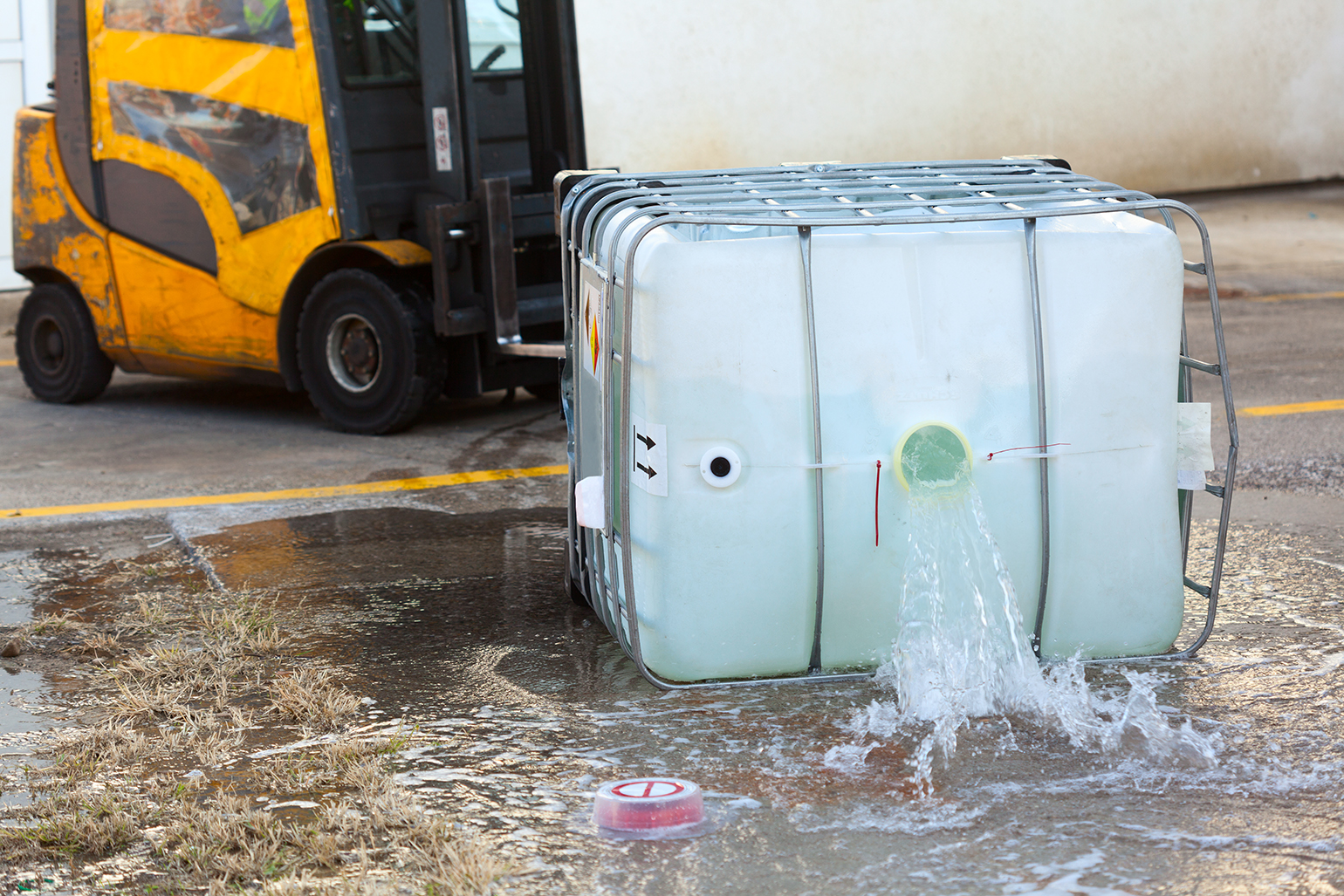

    In Part 1, we looked at the “hold while using” method of preventing small spills. You can easily hold a small solvent can in your hand while using it and easily place it on a cart when not. Try that with even a one gallon paint can, however, and you will quickly fatigue. Another tip for small container use is to seal the container lid if you plan to set the container down for a while.
    But what if you have a larger container? A lift truck or maintenance cart might knock over a larger container. Or, someone might stumble into it, causing a spill.
    You can apply the same working procedure noted above for small containers to any larger container. In other words, don’t use the large container as your working container. Use a funnel, pour spout, or similar means to fill a much smaller working container. The only time the larger container is open is when you need to refill your small working container. If it’s knocked over while sealed, there’s no spill.
