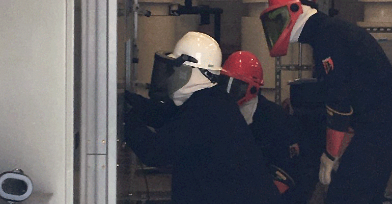

Arc flash boundary — After determining appropriate risk control methods, any applicable safety-related work practices must be identified and associated with each method, including the arc flash boundary and the PPE that is required for anyone that is inside the boundary. The arc flash boundary is the distance at which the incident energy equals 1.2 cal/cm2. The preferred method for determining the arc flash boundary is through calculations associated with an incident energy analysis. In lieu of the analysis, it is permitted to be determined by Table 130.7(C)(15)(a) or Table 130.7(C)(15)(b) when the requirements of these tables apply.
Arc flash PPE — Knowing that there is a potential for an arc flash event to occur, the next requirement is to determine what arc flash PPE is required within the arc flash boundary. The required minimum rating of arc flash PPE can be determined either by the incident energy analysis method in accordance with 130.5(G) or the arc flash PPE category method in accordance with 130.7(C)(15). From the perspective of clearly understanding the severity of the hazard, the incident energy analysis method is always the preferred method. However, the incident energy analysis method requires data collection, system modeling, and calculations, all of which take time. In lieu of this method being finalized, NFPA 70E allows the use of Table 130.7(C)(15)(a) or Table 130.7(C)(15)(b) to determine required PPE when the requirements of these tables apply.
Documentation — Arc flash risk assessment results are required to be documented. Documentation can take many forms depending on the level of risk and the complexity of the mitigating actions. Low risk tasks may simply be documented as part of the job planning document while higher risk tasks may have a separate arc flash risk assessment document. If the arc flash risk analysis involves performing an incident energy analysis, documentation may include labeling equipment with incident energy analysis results. As stated in 130.6(H), electrical equipment that is likely to require examination, adjustment, servicing, or maintenance while energized is required to be marked with a label containing the nominal system voltage, arc flash boundary distance, and an indication of the minimum PPE required within the arc flash boundary.
