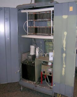

Photo 1. This is an interior view of the cabinet housing the test load equipment.

The incident involved a test load that was not a commercial product but had been assembled specially for or by the power supply manufacturer for internal use of testing its products (Photo 1). That is, the company (and/or its predecessor companies) had hand-built a small number of special apparatuses that would appear electrically (to the power supply) the same as apparatuses to which the power supply would be connected in use elsewhere.
As noted in the power supply manufacturer’s testing procedure, the test load is denoted “Appropriate H.V. [high-voltage] load.” The test load apparatus is housed in a padlocked metal cabinet standing about 6 ft tall and equipped with casters. When either cabinet door is opened, the test load exhibits exposed electrical components, including high-voltage terminals. This apparatus simulates the load on the power supply by triggering (or actuating) a thyratron to close a circuit connected to its resistor-capacitor bank (Photo 2).
Photo 2. The resistor stack at the top of the cabinet simulates a load during testing.
The thyratron is a gas-filled “vacuum tube” that acts as a switch. When the thyratron conducts in response to one or more trigger pulses, the energy of the power supply is dissipated by the resistor-capacitor bank as heat. Therefore, the test load is an “active load” in that trigger pulses can be run with a single pulse or repetitively (under control of an operator), thereby exercising the range of capability of the power supply under test.

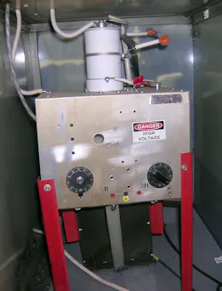

Photo 3. Interior of the test load cabinet showing high-voltage circuitry.
Pausing the test sequence, the technician reached into the test load cabinet to effect an adjustment to the bias network, which is an electronic circuit associated with (and adjacent to) the thyratron (Photo 3). Reconstruction reveals that the technician’s right hand contacted the thyratron anode and his left leg made contact with the grounded cabinet door. The resulting current flow through his body resulted in burns and electrocution. The victim was found on the floor beside the test load cabinet a few minutes later and was unable to be revived.
Immediately after the accident, the right cabinet door was observed open, and the left cabinet door was closed. The thyratron was inside the right door but mounted low — reachable only from a stooping or crouched position. Damage to the victim’s right hand included burned flesh, of which residue was later found on the thyratron anode. Similarly, damage to his left leg matched a burn scar low on the edge of the left door.

Photo 5. Note the small “Danger High Voltage” sign located inside the cabinet.
• Although the employer posted generic warning signs about the presence of high voltage (Photo 5), nothing indicated the particular danger presented by the thyratron anode and other live parts contained within the cabinet. In particular, the company provided no instructions or warning about residual charge on the high-voltage capacitor(s).
