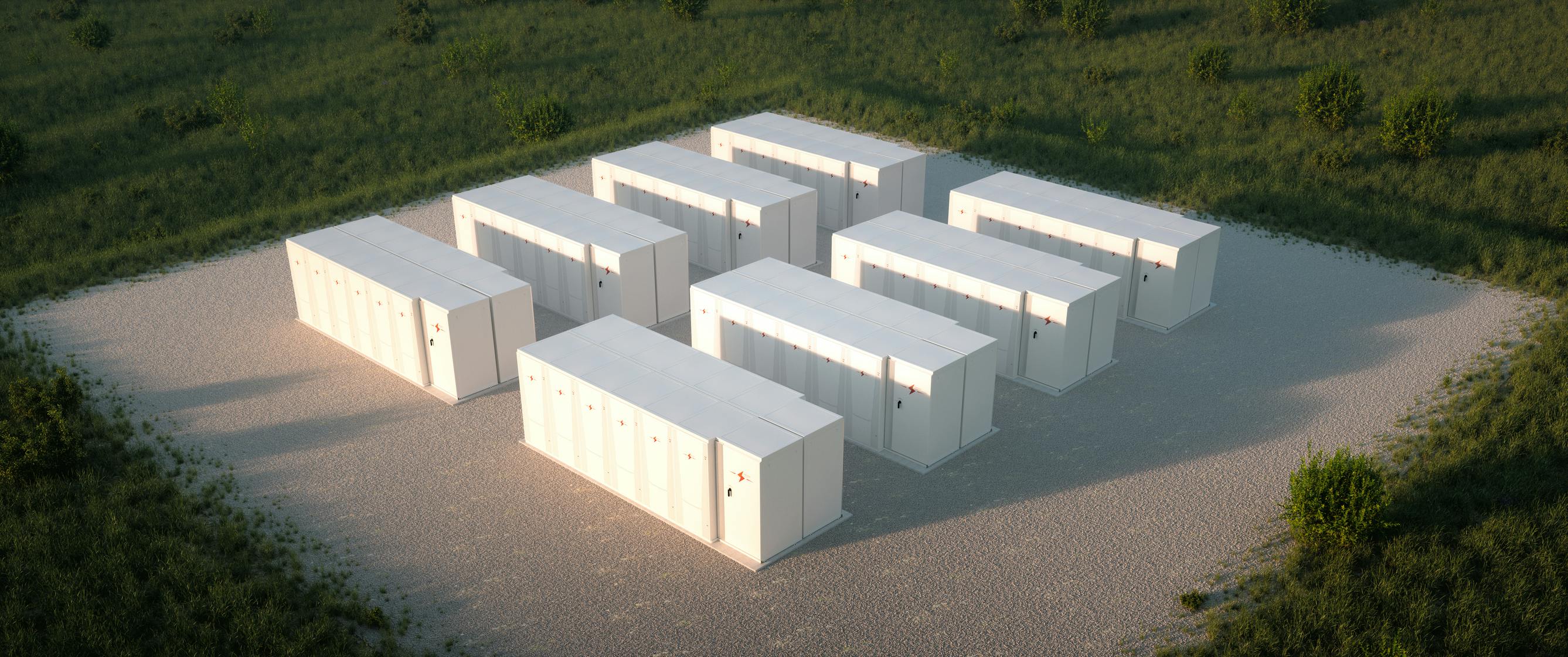

    A signature development in December was a $30 million grant from the California Energy Commission (CEC). That money will help fund a battery facility that will employ Somerville, Mass.-based Form Energy’s iron-air battery technology to continuously discharge to the grid for 100 hours, far exceeding the standard four to six hours typical of present-day battery storage and even that of many other LDES demonstration projects underway nationally. The 5MW/500MWh plant (expected to be operational in late 2025) will be built at a Pacific Gas & Electric substation in Mendocino County.
