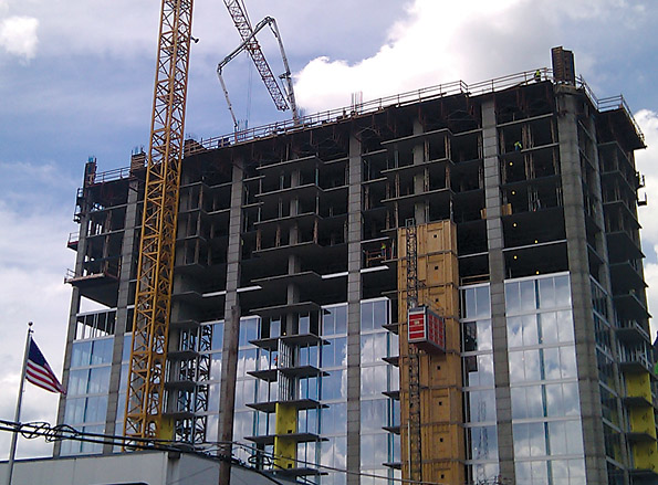

Like the other Skyhouse multi-family projects, Skyhouse Austin was built on a 12- to 14-month construction schedule, making it essential to build schedule efficiencies into the project, such as lean construction practices.
Akin says all of the buildings feature a similar design electrically and structurally, which creates a synergy among team members. By having the same experienced crews working on multiple projects, the project team can maximize efficiencies and control project costs.

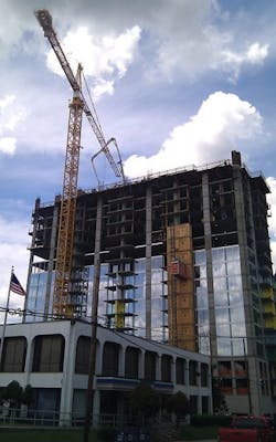

To speed up construction on the job, the team also built a seven-story precast parking garage adjacent to the apartment tower rather than directly underneath it. That way, the construction team didn’t need to perform an elaborate amount of foundation work. In addition, the field workforce could hit the ground running when it came to the construction of the tower, says Jack Brock, vice president of preconstruction for Faith Technologies.
Another way the team was able to meet the deadlines on the fast-track project was by installing mechanical equipment on each floor rather than on the roof of the completed building.
“One of the most unique aspects of this job was the speed in which it needed to be completed,” says Brock. “The project needed to be turned over quickly, and mechanical systems typically have a long lag time. By putting the mechanical systems on each floor, it facilitated a faster buildout, because the field workforce didn’t need to wait for the entire structure to be completed or build the vertical pathways up to the roof before they could get the mechanical systems operational.”
The electrical and mechanical team installed the central systems up on the roof, but all the equipment that served the residential units was installed out on the balconies and concealed architecturally. As such, the team was able to pick up a lot of time in the schedule, explains Brock.
The electricians installed two 4,000A services to feed the residential tower and a 400A service for the parking garage. In addition, they put in a 600kW emergency diesel generator, 2 million ft of branch circuit wiring, and 200,000 ft of power distribution wiring.

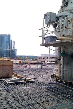

Polyethylene pipes were routed through the rebar prior to each concrete pour.
“On a traditional job, the trades all focus on their own specific scope of work and their coordination with one another,” he says. “On this project, we had to go out of our way to help each other succeed. Otherwise, the challenges one trade was experiencing would domino down the line, impacting the construction schedule and causing us all to fail.”
The demand for teamwork was especially important because the builder worked on a three-day concrete pour cycle. In other words, every three days, the workers poured an entire floor of the building, and all the trades, including the electrical team, had to keep up with this fast-paced schedule. It took about five months from the time the site was graded off to when the project was poured out, and then the interior buildout took another six to seven months.
