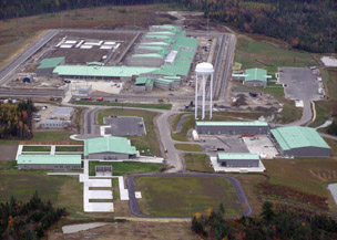

The U.S. state prison population may be at its lowest level since 1972, but the federal inmate populace has reached an all-time high, according to 2010 survey data compiled by the Public Safety Performance Project of the Pew Center on the States in partnership with the Association of State Correctional Administrators. To help house some of the nation’s more than 217,000 federal offenders, the Federal Bureau of Prisons (BOP), an agency of the U.S. Department of Justice, recently constructed a $247-million Federal Correction Institution in Berlin, N.H. (FCI Berlin).
The medium-security complex sits on 770 acres and consists of 25 buildings, including three 4-story general housing units, a 2-story special housing unit, and numerous 1-story facilities for educational, vocational, health, administrative, and food services.
