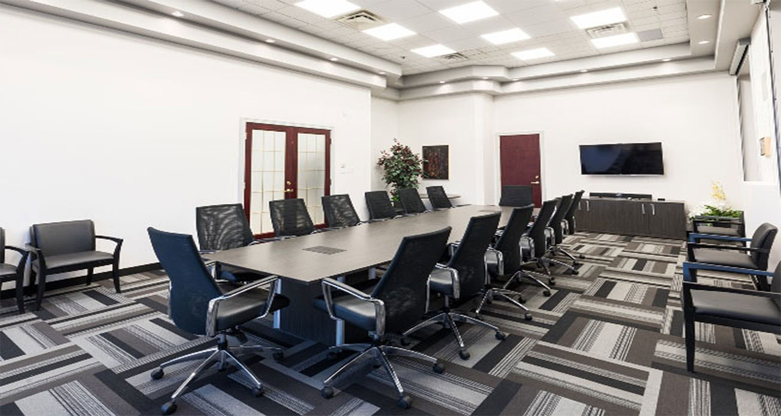

Working with a local contractor, the Gavin Centre set about replacing lamps and luminaires throughout the building, including in the suites, the boardroom, bathrooms, corridors, and lobby area. They also replaced wall packs on the exterior of the building.
Inside, a mix of 2-ft x 2-ft and 2-ft x 4-ft LED panels were installed for general illumination, all with uniform 3,500K color temperature and 0V to 10V dimming capabilities. In all, approximately 150 fluorescent luminaires were replaced with contemporary LED panels throughout the building’s interior.
