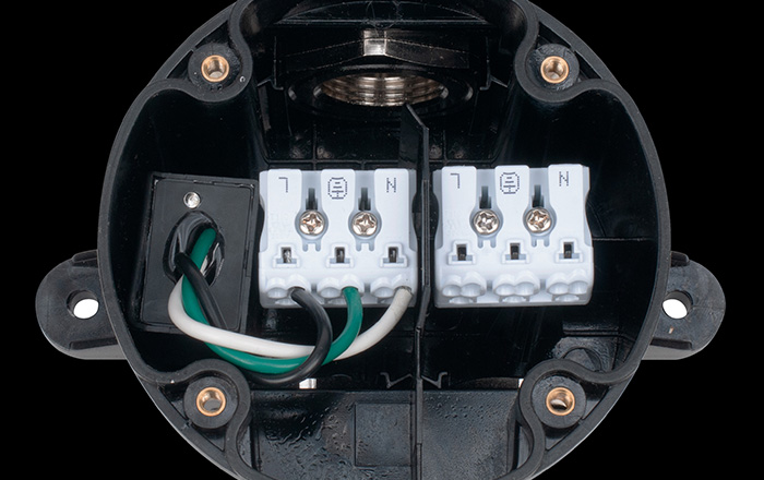

The AJBOX1 from Acclaim Lighting is a weathertight, outdoor-rated junction box designed to separate the company’s hybrid cables into separate AC power and DMX conduit runs for quick and easy installations. Providing a physical barrier between high and low voltage to comply with NEC  requirements, the box features push terminals to quickly connect cables with an integral 5kA, 10kV built-in surge protection for any fixtures in line. In addition, the product can handle a total line wattage up to 1.8kW at 120VAC and 4.155kW at 277VAC with a maximum conductor size of 12 AWG and maximum input voltage of 390VAC. Its maximum connection amperage is 15A. Other highlights include two ½-in. NPT conduit inlets for separate AC and control cable inputs, and one ¾-in. NPT external conduit outlet for the hybrid feed cable. The internal connections include two 3-conductor push terminals for AC and control links.
