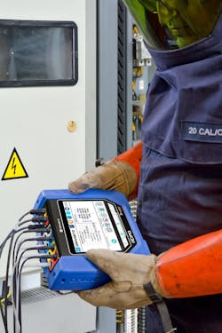

Setting up the PQ meter
Again, it’s recommended to use an IEC 61000-4-30 Ed 3 Class A compliant PQ instrument. Before recording data, make sure:
- The meter’s firmware is current.
- The meter has been recently calibrated.
- Its internal clock is set correctly, including the correct time zone.
Timestamps matter. Your ability to correlate PQ events with processes, equipment faults, and other meters depends on accurate time alignment. When using multiple PQ (or other) meters simultaneously, it may be beneficial to use an external time synchronization source (if available), such as NTP or GPS. This will give you the confidence to correlate PQ events accurately to recordings of other meters or systems.
If the meter supports remote access, test the connection (Ethernet, Wi-Fi) before closing panels or stepping away. And remember to always follow facility safety rules, such as those outlined in NFPA 70E, comply with company and local policies, and ensure only qualified personnel perform testing and use appropriate personal protective equipment (PPE).
