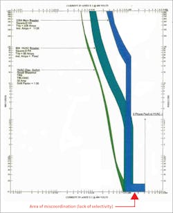

The investigation revealed that one of the HVAC units sustained a failure (i.e., shorted heater strip). The fuses were blown in the HVAC disconnect switch to this unit. The failure also caused the main breaker in the 480V distribution panel to trip (the branch circuit breaker remained closed). What appeared to be an apparent miscoordination of the panel breakers and the HVAC fuses warranted further investigation.
Classic case of miscoordination
Why did the distribution panel main breaker trip instead of the branch breaker for the HVAC unit? Upon further analysis, the answer for this sequence of events was obvious and is a textbook case of a lack of selectivity for circuit breaker protection in a panel where the available fault current is high — and there is not enough separation of overcurrent device ratings to provide selectivity and coordination.
The available fault current at the 480V distribution panel was fairly high. Since the main breaker and the HVAC feeder breaker were close in size (rating), there was no coordination for a significant fault; the magnitude of fault current fell into the instantaneous region of both breakers and the fuse in the HVAC circuit (see TCC curve in Fig. 2).
While this issue is not easily corrected [it would probably require a major redesign of the panel (i.e., a new panel with a main breaker, and possibly an adjustable solid state trip unit)], a more affordable solution was to reconfigure the panel by moving the non-critical loads to other nearby electrical distribution centers, reducing the risk of exposure.

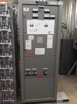

As part of the event investigation, a review was performed of the other four UPS systems in this production unit to identify similar risks. The following items were discovered as potential risks, which could affect the future reliability of the emergency power for the CHEM1 UPS equipment:
  • Four of the five units were supplied by VRLA battery banks.
  • Lack of redundancy for normal and alternate power for all five units (i.e., normal and alternate power were fed from the same upstream source).
  • Comingling of loads in the 480V primary distribution panel to the UPS (i.e., critical vs. non-critical loads, such as lighting and HVAC in the same panel as the UPS supply).

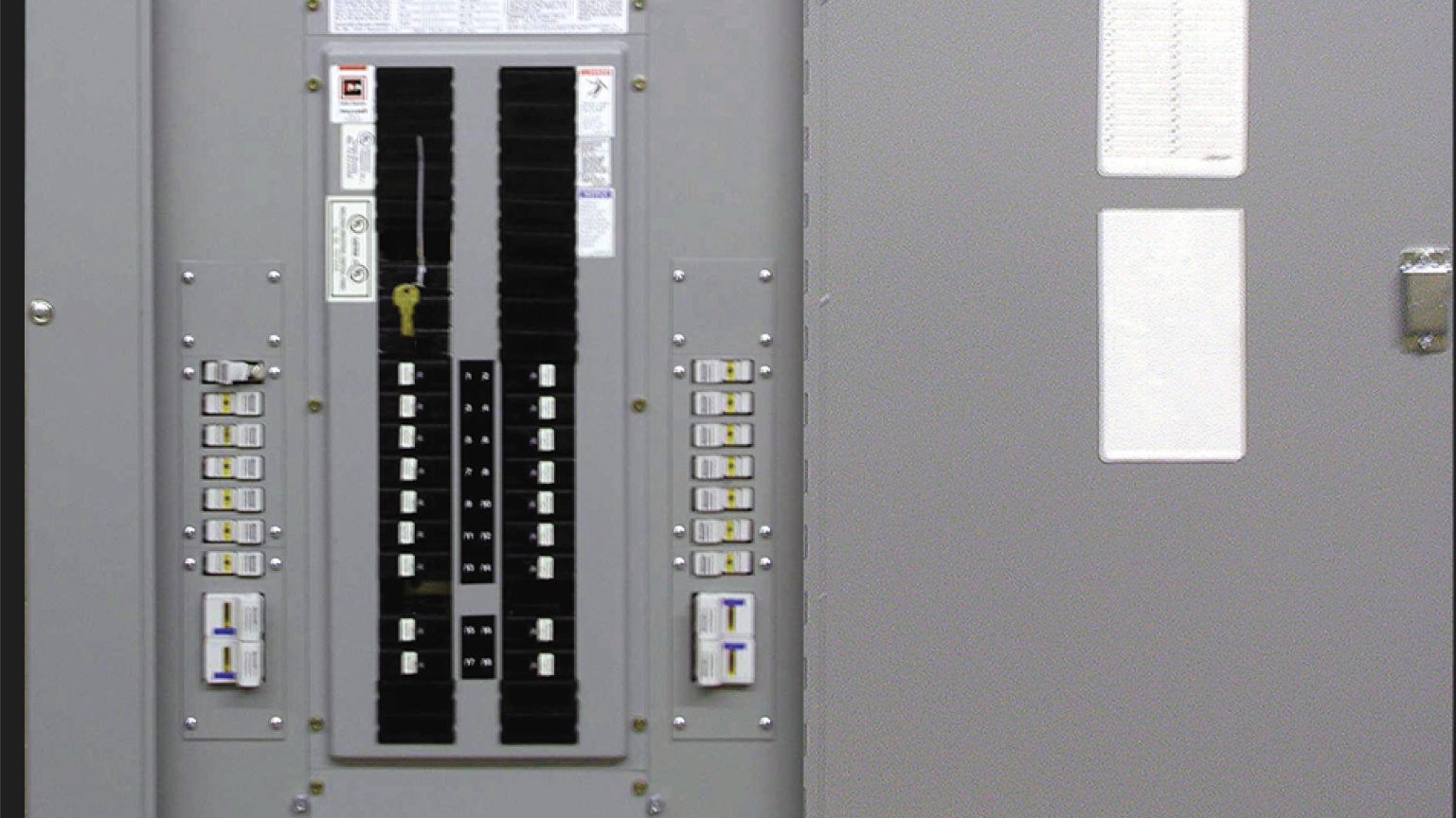

  • Several of the UPS output power panels were standard commercial power panels with standard molded-case circuit breakers (MCCBs). They were not the type recommended by most UPS manufacturers (e.g., a panel with fused disconnects utilizing high-speed semiconductor fuses).
  • Two of the UPS units had no remote maintenance bypass switches (also known as “wraparound“ maintenance bypass switches) to allow complete isolation of the unit. They had an internal bypass mode only. Internal repairs to these units could only be made during a plant outage.
  • The five units were made by multiple manufacturers of UPS equipment — no standardization.
  • Three of the UPS units were obsolete.

CHEM1 processing unit
The improvements (e.g., load separation, separate normal and bypass supply segregation and battery upgrades) had already been implemented for CHEM1 as previously explained.
UPS panel replacement — three of the existing eight UPS output panels were standard commercial/residential type distribution panels with MCCBs. These panels were replaced with fused disconnect switch panels to provide high-speed clearing of faults. Two of the existing panels had to be replaced with hybrid-type enclosures with custom-fabricated equipment due to the close clearances of the existing installation.
Standardization — three obsolete units were upgraded to the standardized manufacturer. Standardization provided the following benefits:

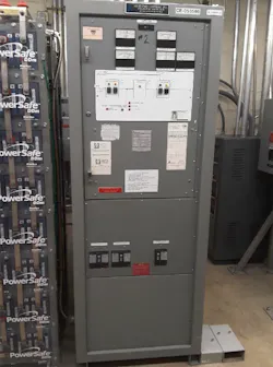

The UPS unit for the CHEM5 facility was faced with imminent obsolescence. The decision was made to replace the unit before it became a legacy system. Also, this unit would have required significant investment to replace spare warehouse parts where the shelf life of the boards was expired.
There were significant real estate issues involved with replacing this unit. A solution was reached by evaluating the size rating of the unit. It was discovered that the unit could be downsized (from a 15kVA to a 10kVA rating) and still meet CHEM5 backup power requirements. This allowed the installation of a smaller physical cabinet (1/2 size), which expedited and facilitated the replacement.

A UPS output power panel (for UPS4, CHEM1) sustained a fault on one of the branch circuits due to a computer system power supply failure. The fuse in the UPS4 output panel operated to clear the fault. No other loads were lost from that panel. This can be credited to the installation of the high-speed fault-clearing fuses that were installed as part of the panel upgrade.
One of the primary 13.8kV utility power supply feeders coming into the CHEM1 plant was lost due to a fault, resulting in a complete loss of power to one of the substations providing normal power to some of the UPS units. The UPS units fed from this substation immediately went to battery. However, one cell in the unit’s DC battery subsequently failed. The unit switched to the bypass source upon DC bus failure (by design). The substation supplying the bypass source was not affected by the utility loss. While this is not the intended sequence for emergency backup, the ability to switch to an available Alternate source saved the processing unit. Before the implemented changes, this failure could have resulted in a plant shutdown or extensive rate reductions because both of the power supplies (NORMAL and BYPASS) were on the failed feeder. Note: The loss of the 13.8kV feeder only affected some of the process equipment in CHEM1, which allowed the plant to keep running but at reduced rates.
The UPS in the CHEM5 processing plant sustained a major failure (i.e., failed ferroresonant transformer). The unit switched to the alternate source (via the internal static switch) and continued to supply outpower power to the facility, resulting in no lost production. Because the unit had a wrap-around remote maintenance bypass switch, the unit was replaced with a new unit without requiring a facility outage.
