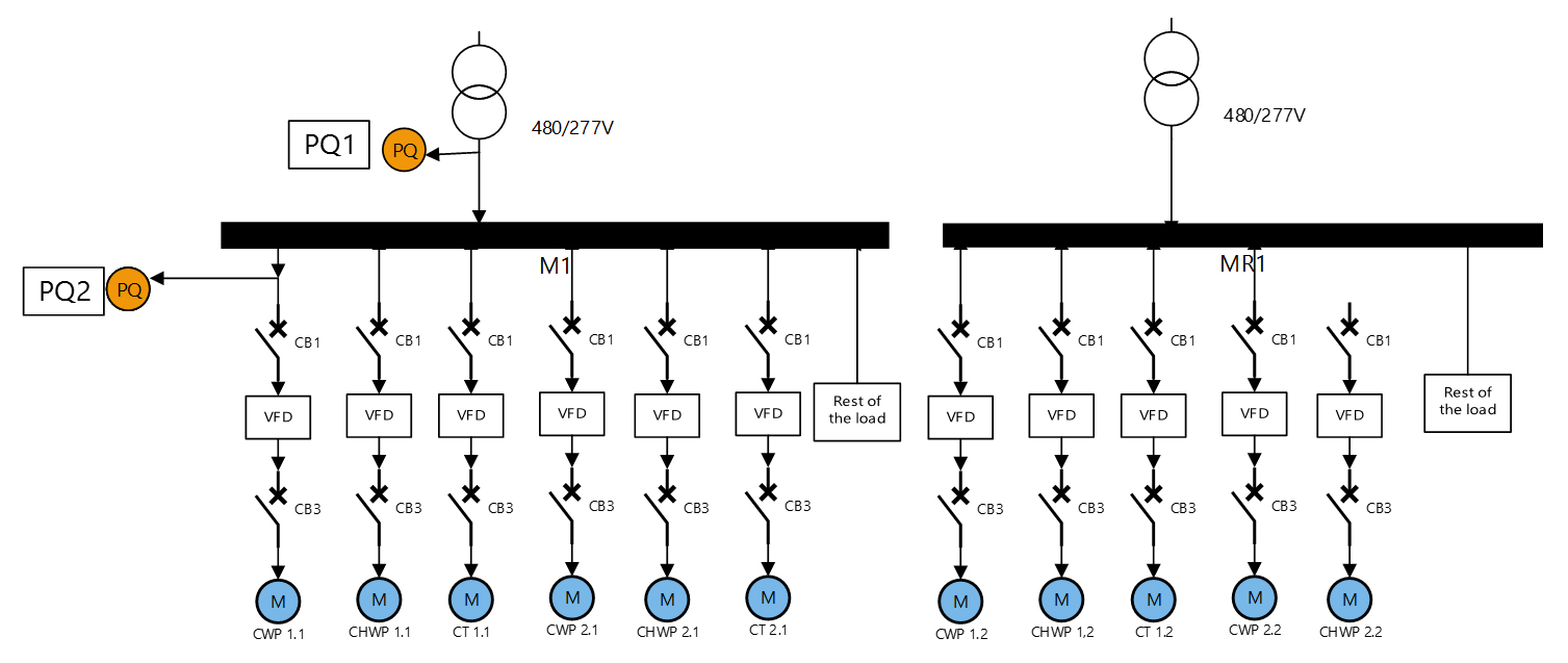

Fig. 1. Note the location of the power quality meters in this electrical system configuration.

This case study involved a client who requested a study after variable-frequency drives (VFD) tripped during normal operation. Some actions had been taken to avoid the undesired tripping, and the ground fault protection was disabled for the VFD. The client was very concerned that the protection was disabled. To understand why the system was underperforming and re-enable ground fault protection, the client needed to know if higher ground currents (leakage currents) were the actual cause of the trip events.
An evaluation was conducted during regular business hours over a day-long period of normal operations. A true measurement of the dynamic load behavior of a facility was required to properly capture the information needed. Meters were set for power variable logging in order to capture any significant changes. Two power quality (PQ) meters with a 200-nanosecond (nsec) resolution were connected in two separate locations (Fig. 1):
  1. Meter PQ1 was installed at the load side of the transformer that feeds Bus MR1.This location was modified when analyzing drives connected to Bus M1. Meter PQ2 was installed on the line side of the VFDs.
  2. Drives were de-energized and ramped up from 20-Hz to 50-Hz operation. Measurements on the VFD load side were taken simultaneously with a clamp-on meter and read from the human machine interphase (HMI) device of the VFD. This procedure was repeated for each VFD that exhibited undesired operation.
  3. Finally, the maximum load was cycled to Bus MR1 connecting all the drives and loads, and the process was repeated for Bus M1.
Figure 1 depicts the system and the location for the PQ meters during the first assessment. Similarly, PQ2 was moved to monitor each one of the loads ― in this case VFDs ― that presented undesired tripping conditions.
It is important to mention that the selected procedure implicitly allowed the visualization of the impact of the drive on each feeder and main. The selection of drives to monitor during the tests were based on the client noting the number of events when the VFDs tripped.
After connecting PQ meters, it is important to consider the control aspects of a VFD. This electrical component is commonly used to operate motors (induction machines) measured in scalar volts per Hz control (V/Hz). With this control technique, the torque is maximized in the machine by varying the frequency and voltage of the source and operating the machine at almost constant torque on speeds up to nominal without saturating the motor cage of the machine or adjusting the voltage applied to the unit.
Measurements were taken at the load side of the VFD during the frequency ramp-up as seen in Table 1. Additional measured values over the ramp-up period include the phase and ground currents, total harmonic distortion (THD), phase-to-phase voltage at PQ2, and the harmonic spectrum at both PQ meters. These values were recorded to help identify what defects were occurring in the system and why they were occurring. The data are shown in Table 1, Table 2, and Figs. 2, 3, 4, and 5. All values are summarized in Table 3. The measurements were taken for each VFD, but the data for only one is shown. Table 3 allows for easier assessment of the evaluations run and the results of all the data gathered.
By following the test steps above for each VFD, Figs. 2 through 5 were created, allowing for comparable results for all VFDs. By incrementally ramping up the frequency through the test, how the frequency and speed of the machine affected the currents could be studied. The data points can be stacked on the same graph to more easily show where unbalances exist, such as the approximately 5A difference between Phase A and Phases B and C on Fig. 2. Figures 2 through 5 show the concepts of transient and steady-state well, and show why the tests were performed the way they were. The graphs show how the system handles the transient (the short, dense ripples), how the system responds (the sloping portions), and what happens to the system in steady-state (quasi-flat lines). Notice that the ground current follows the same shape as the phase voltages. Also notice in Fig. 2 and Fig. 3 that there are still some small fluctuations in steady-state for some voltages, which may indicate harmonics. In Fig. 5, a similar visual comparison can be made for how much of each harmonic is present in each phase, which further helps to show the unbalances.
Taking VFD CWP-2.1 as an example (shown in figures, tables, and in bold in Table 3), we see a current unbalance of 12.77%, which is one of the highest recorded for this system. It also has a high current unbalance on its corresponding feeder at 4.46% and a high ground current of 0.42A during the test. The manufacturer recommends that the line input current to the VFD should not vary by more than 3%. This VFD exceeds that recommendation. Though high, the ground current is below the 2% standard value for ground leakage.
The main conclusion that can be drawn from analyzing Table 3 is that there is a correlation between high, unbalanced current percentage and the ground current associated with these events. As the frequency increases and the machine speeds up, there is more ground current flowing in proportion to the frequency (Fig. 2 and Fig. 3).
With data and analysis in hand, the team could recommend procedures to identify and eliminate system defects, improve system performance, and prevent future events. The first recommendation: Verify the balance of the loads on the system and lower the current unbalance percentage. Leaving the unbalance could lead to de-rated power cables, increased losses, increased cost, and decreased efficiency, among other negative effects. Second, verify the unbalance levels seen on the VFD line side during the ramp-up with the manufacturer, as the unbalance creates an abnormal loading condition for a low-voltage drive. The VFD may treat the unbalances in current as a phase fault and can trip on earth fault or missing phase fault, which the client’s log showed multiple instances of. Finally, verify the high ground leakage currents in the downstream motors to detect any small insulation breakdowns, especially since there’s a record of previous fault conditions.
