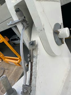

Myth #4: Grounding of the canopies and LED luminaires installed on the canopies had nothing to do with the malfunctions and failures of the LED lighting system. (Grounding of structures, electrical systems, and electronic loads don’t do anything — so it’s not important. Therefore, questioning it shouldn’t be included in a PQ investigation.)
Fact #4: Grounding of the LED luminaires, the driver, and the canopy structure played a key role in the malfunctions and failures of the LED lighting system. (Properly grounding of metal infrastructures supporting LED lighting, lighting fixtures, and the drivers within helps stabilize (keep close to 0V) the whole grounding system, especially when voltage surges impact AC power circuits and control circuits.)
Myth #5: New LPS installations on large outdoor metal structures (interfaced with existing LPS-protected buildings) that must support programmable LED lighting will perform the same as LPSs installed on large building structures that must support programmable LED lighting.
Fact #5: Careful installation and evaluation of the bonding of the components of the metal structure and the bonding of LPS connector hardware and its down conductors must be carried out to ensure the LPS system operates under low impedance conditions to help ensure adequate protection and performance of electronic loads like LED lighting. This type of installation is not the same as what you find on a typical building structure.
