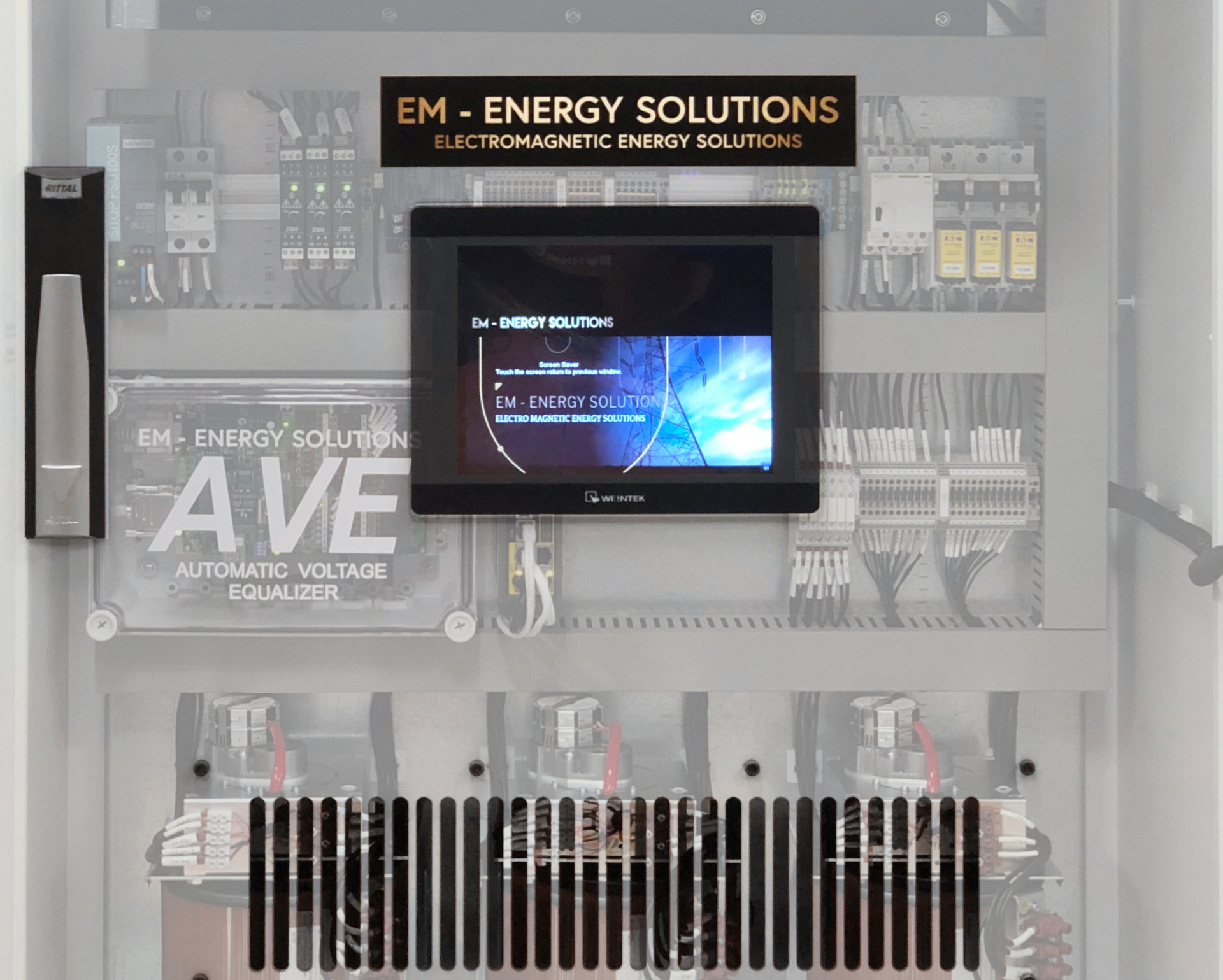

RECENT DEVELOPMENTS: There is new, emerging WBD technology now becoming available. Historically, WBD Grounding Transformer arrays utilize fixed instrument transformers. However, EM Energy Solutions, LLC, Automatic Voltage Equalizer (AVE) Grounding transformer arrays are now becoming available using servo driven autotransformers instead of fixed isolation transformers. In addition, a Power Quality Monitor (PQM) and a precision servo system is also incorporated into the AVE, as well as a Communication (Modbus and Bluetooth) package. The action of the on-board PQM is to; 1) monitor voltage system activity, and 2) to provide voltage, current, and phase angle information to the servo controller. This raw data is then processed to enable the servo system to re-balance the system voltages and phase angles. As this is happening, the Modbus is used to notify the system operator of changing conditions.
This approach is able to perform ground fault mitigation in two succinct steps. Since a ground fault on ungrounded voltage systems causes the grounded phase to SAG, the remaining two ungrounded phases can SURGE to severe over-voltages. This may be longer than can be mitigated without damage by conventional Surge Protective Devices (SPDs). So, the AVE can act as both a SAG and SURGE mitigation device.
First, the normal WBD action of phase voltage recovery occurs, generally in 1 – 2 milliseconds. Second, the imbedded sensors (within the AVE array), provide inputs for the AVE servo controller to re-position the autotransformers to restore phase voltage balance. This is seen to occur in 2-3 seconds. Figure 6 shows this occurrence, taken at a large shipyard automated welding site.
Figure 6: Action of Dynamic WBD Grounding Array
The waveform log above is captured by the internal Power Quality Monitor within the AVE during automated welding machine operation and shows the exact moment when the AVE activated. The waveform before the AVE activation is distorted with a high voltage unbalance (8-9%). After AVE activation, we see a short transitional period of 30-40ms where the unit stabilizes the system, removes harmonic distortion, eliminates transients, and reduces voltage unbalance (0.5%).  Finally, after the AVE is activated, we can see a perfect three-phase sine waveform and a 100% balanced system.
