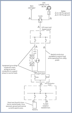

During our review, we found that the neutral (grounded) conductor was still connected from the main switchgear and generator, through a 4-pole transfer switch to the input and bypass switchgear of the UPS system. The neutral was not run to the UPS input or output, but was instead connected to the maintenance bypass panel. From the maintenance panel, it ran to the UPS distribution panel. From there, it was also connected to Panel EL (Fig. 1).
The fact that neutral wires being installed and connected in the system was not in and of itself an issue. In a new installation, the neutrals would not have been run to save money. But because this was a retrofit — and the wires were already there — it would have cost more to remove them.
We also checked for current flow on the ground and neutral conductors. Since the UPS system is a 3-wire system  — and would not allow for line to neutral loads — there should be no current on the neutral conductor. Ground current should only exist during a fault. However, we did find current on both neutral and ground conductors. We traced the source of this to Panel EL, which contained several single-phase circuits with neutral conductors. Later, these loads were found to be emergency lights.
Before we verified and removed the single-phase loads, the site experienced a power outage that resulted in the loss of the critical load. This time the PQAs captured the event. The data collected on the output of the UPS unit was indicative of a phase-to-ground fault on an ungrounded system. Figure 2 shows B phase potential go to zero with respect to ground and A and C phases increase in potential with respect to ground.
After several conversations with the UPS manufacturer, we now understood how this specific unit handled line-to-ground faults. When the load was being supported by the inverter and bypass power was available, the inverter would go into current limit mode and transfer to bypass. The overcurrent protection devices would then operate, protecting equipment and personnel. If the load was being supported by the inverter while operating from batteries, logic would turn off the inverter.
We established that during electric utility operation the line-to-neutral loads were supported through the neutral conductors (where available) and through the UPS input and output equipment grounding conductors (EGCs) when the neutral was not available. When the UPS was on batteries, the logic sensed the ground current as a ground fault and shut down. The system did not shut down on every outage because of a small delay in the logic to be sure there  was a legitimate ground fault, which prevents nuisance trips.
The load of the emergency lights was only several amps and not large enough to operate the overcurrent protection devices. The UPS logic, however, was much more sensitive. When operating on batteries, it sensed this current as a ground fault and would shut off the system to protect equipment and personnel.
