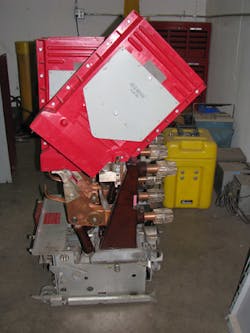

Arcing Contacts
Arcing contacts are designed to prevent the main contacts from being damaged and can be made of alloys of silver, cadmium, tungsten, and zinc. The tungsten, cadmium, and zinc make the arcing contacts harder, so when the contacts open and close they will not deteriorate as quickly. When the circuit breaker opens, the main contacts part first and then the arcing contacts part, drawing the arc across them. When the circuit breaker closes, the arcing contacts make first, again drawing the arc across them. This prevents the main contacts from carrying the arc and preserves them.
The contact surfaces are shaped so that they have a rubbing motion, referred to as “wipe.” Wipe helps clean the contact surface, and is caused by one of the contact surfaces being contoured and the other surface being flat. When the contacts close, the contoured surface will have a wiping motion against the flat surfaced contact. Arcing contacts will usually have an arcing “horn” on the very top of the contact structure. The arcing horn aids in transferring the arc from the arcing contact to the arc runner in the arc chute.

Photo 11 shows an arc chute arrangement on an air-magnetic circuit breaker. Photo 12 shows the detail of a blowout coil assembly of a circuit breaker. The blowout coil is energized when the contacts part, forcing the arc current through them. This creates a magnetic field that pulls the arc into the arc chute more quickly.
