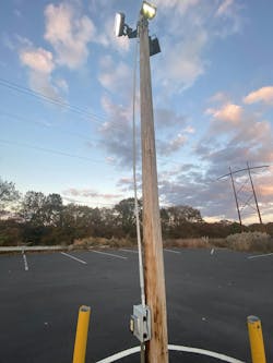

Clipless Conduit
I don’t know how it happened, but every clip that was installed to secure this rigid PVC conduit is gone. Only small remnants of each clip remain attached to this pole. Perhaps the clips were not sunlight resistant as required by Sec. 300.6(C)(1) and disintegrated from long term exposure to the sun. Unfortunately, I have seen that happen in several installations.
Table 352.30(B) requires ¾-in. rigid PVC conduit to be supported at intervals no greater than 3 ft. This conduit run may have complied with that requirement when it was originally installed, but it most certainly does not comply now — leading to a big bow in the conduit. On a more positive note, the installer did include an expansion coupling in the PVC conduit run as required by Sec. 352.44(A).
One other problem I spotted with this installation was the lack of a cover for the receptacle installed in the box near the bottom of the pole. Section 406.9(B)(1) requires 15A and 20A, 125V and 250V receptacles to be installed in enclosures that are weatherproof whether or not an attachment plug cap is plugged in. This enclosure is wide open to wind, rain, snow, and all the elements Mother Nature can throw at it.
