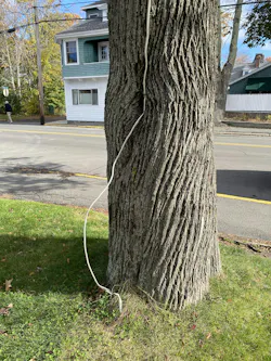

While Sec. 225.26 prohibits vegetation such as trees from being used to support overhead conductor spans, installing UF cables up trees in the manner shown in the photo is not specifically prohibited. Section 410.36(G) permits trees to be used as support for outdoor luminaires and associated equipment. Providing some protection for the UF is certainly necessary, however.

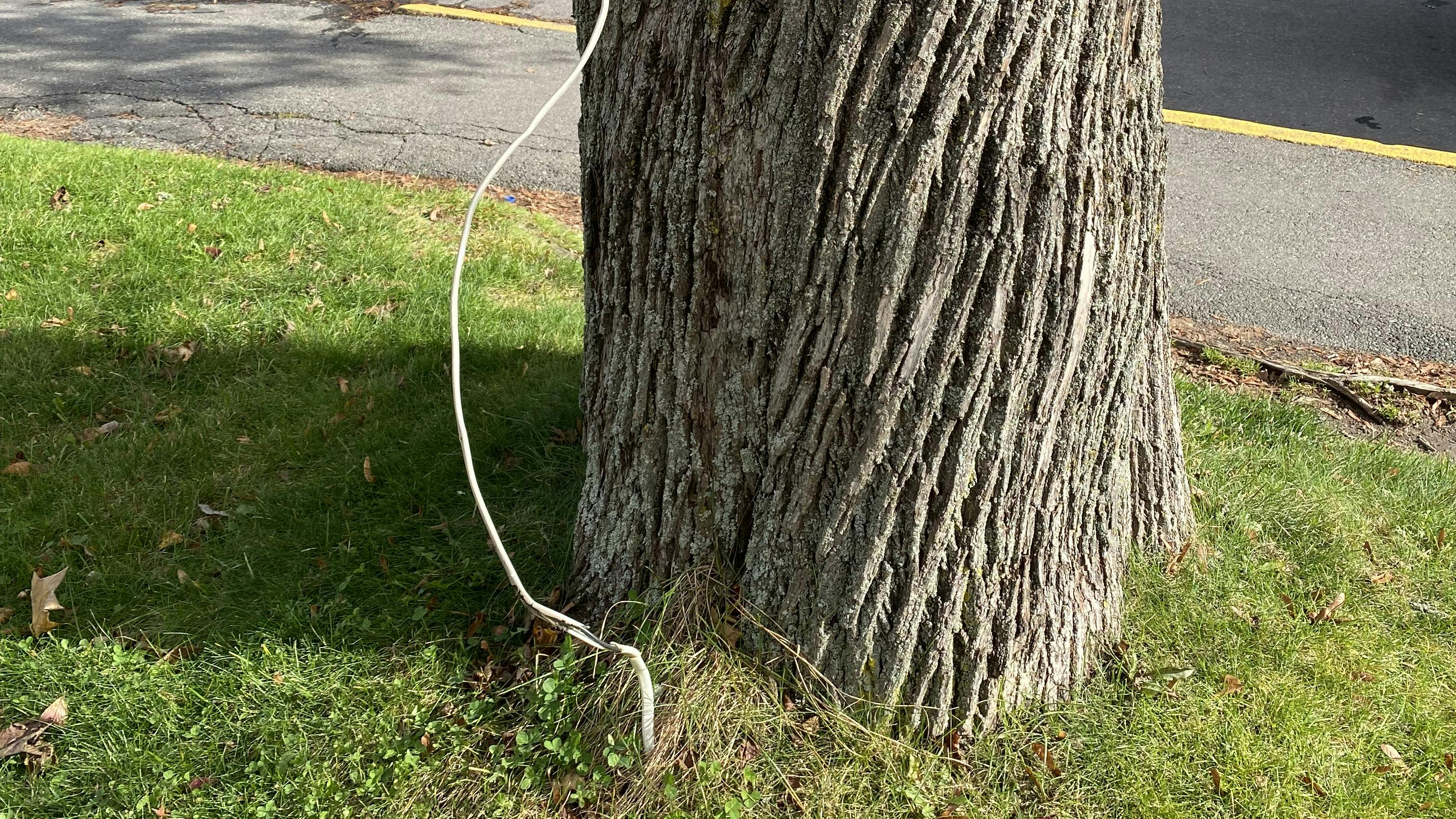

A closer look at the UF cable just a few inches above where it emerges from the ground reveals that this UF is all chewed up and damaged. Perhaps a lawn mower or weed trimmer caused this damage. In any case, stapling a UF cable up a tree with no protection against physical damage is a violation of Sec. 340.12(10). Section 300.5(D)(1) requires direct-buried cables emerging from grade to be protected by raceways or other enclosures to a point at least 8 ft above finished grade. This protection must also extend below grade to the minimum cover requirements specified in Table 300.5(A). On a slightly different but related topic, for temporary holiday lighting, the exception for Sec. 590.4(J) does permit trees to support overhead spans of branch-circuit wiring.
