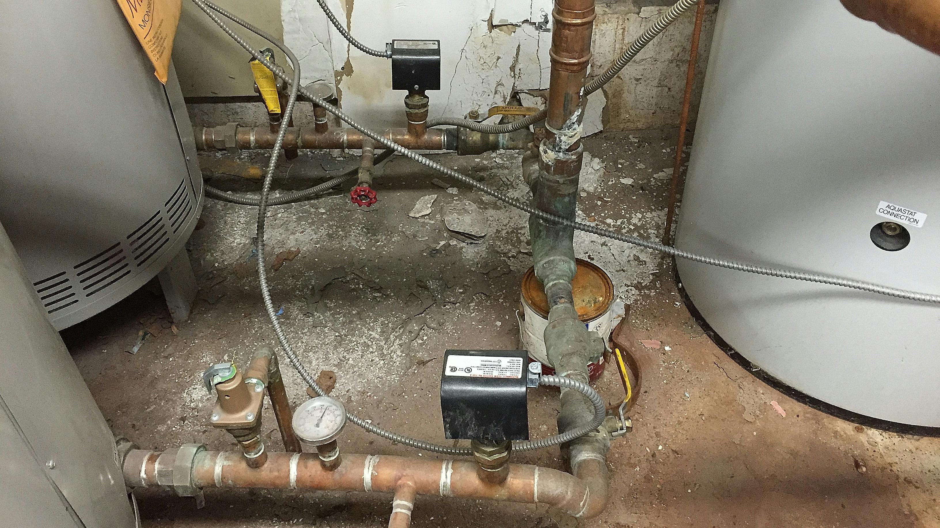

A Flexible Metal Conduit Calamity
I guess the installer of this flexible metal conduit (FMC) figured securing and supporting the conduit was “optional.” I saw many runs of FMC simply strewn about the water pipes and other piping systems in this mechanical room. Section 348.30(A) requires FMC to be securely fastened in place within 12 in. of each box, conduit body, or other conduit termination. That didn’t happen here. That same Section also requires FMC to be supported and secured at intervals no greater than 41/2 ft. While portions of these conduits may be “supported,” I would not consider any of them properly “secured” other than at the connectors securing the FMC to the enclosures.
There are four exceptions allowing supporting and securing options that differ from the requirements of the general rule. However, none of those exceptions apply to any of the 3/8-in. FMC shown in this photo. In fact, 3/8-in. FMC probably should not have been used here. Section 348.20(A) places restrictions on using FMC smaller than trade size 1/2-in. There are certain scenarios described in Sec. 348.20(A)(1) through (A)(5) where 3/8-in. FMC could be used, but none of those scenarios apply to the wiring for the controls of these hot water tanks.

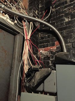

A Sloppy Slew of Code Violations
Where do I even begin? There are so many problems here. I suppose the most immediate problem is the gaping hole bashed through the wall above the door to this electrical room. There is absolutely zero firestopping for this hole as required by Sec. 300.21, and smoke/fire could easily spread from one side of the wall to the other side — and all through the building. There is a variety of cables in that giant bundle (including NM cables) that are not permitted to be installed exposed in this multiple occupancy building. Section 334.10(3) requires these NM cables to be concealed within walls, floors, or ceilings providing a 15-minute finish rating. None of the NM cables or AC cables are supported and secured properly. According to Sections 320.30(B) and 334.30, these types of cables are required to be supported and secured within 12 in. of each enclosure where they are connected and at intervals no greater than 41/2 ft. Several of the red fire alarm cables have been spliced without being installed in enclosures, boxes, fire alarm devices or utilization equipment, or listed fittings in violation of Sec. 760.130(B)(1).
