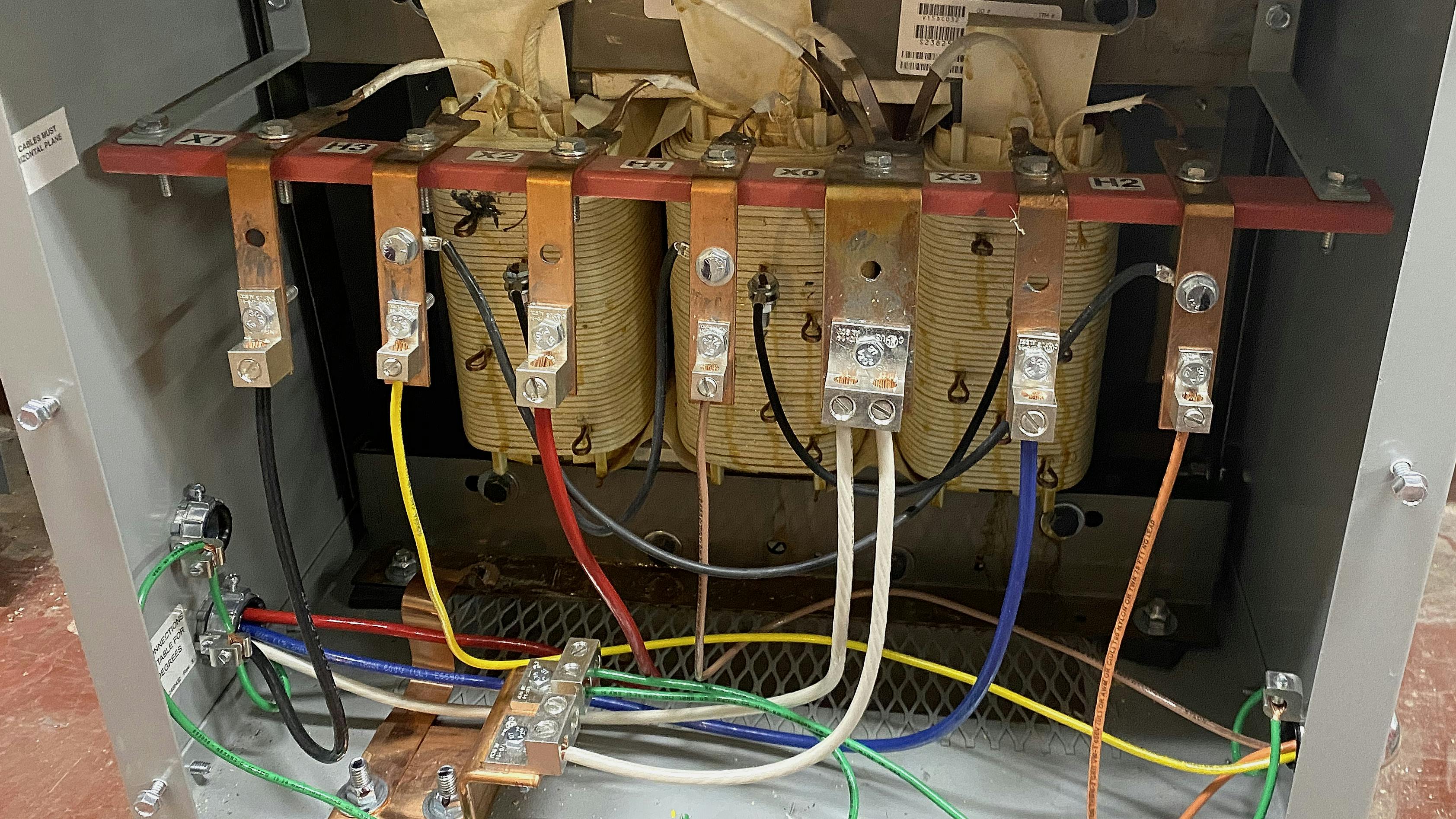

Can a System Bonding Jumper Be White?
I often see transformer installations where the installer uses a white wire as the system bonding jumper. Is this permitted? Or is it a violation? Well, let’s look at some of the applicable rules.
Section 310.6 outlines requirements for grounded conductors, equipment grounding conductors, and ungrounded conductors. For insulated grounded conductors, we are referred to Sec. 200.6. For equipment grounding conductors, we are referred to Sec. 250.119. And for ungrounded conductors, we are referred to Sec. 310.8(B)(1), Sec. 210.5(C), and Sec. 215.12(C). But none of these sections applies to a system bonding jumper.
Could the system bonding jumper be black, red, or blue? Yes, it could. There are no Code rules that prohibit the use of these colors or any other colors typically reserved for ungrounded conductors. Can the system bonding jumper be green? Yes, it can. Section 250.119 states conductors with green insulation cannot be used for grounded conductors or ungrounded conductors but does not prohibit system bonding jumpers from being green. Finally, can the system bonding jumper be white? No, it cannot. For circuits of 50V or more, Sec. 200.7(C) restricts the use of white or gray insulation to only grounded conductors unless part of a cable assembly where the insulation is reidentified for use as an ungrounded conductor or in flexible cords used for connecting appliances or equipment per Sec. 400.10.
