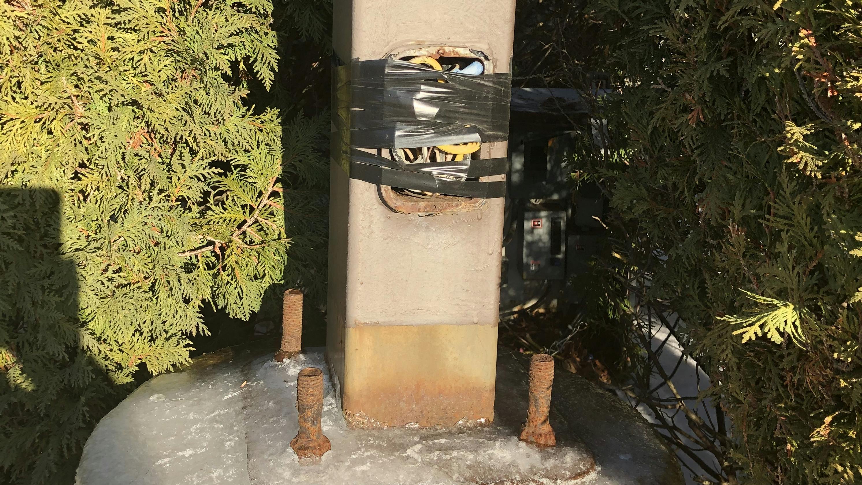

A big “thank you” goes to Daniel K., an electrical engineer from Boston, for sharing this photo with us. In Daniel’s words, he found this “public electrocution shock hazard” at a parking lot pole light for a shopping plaza.
I agree with Daniel that the missing cover increases the risk of getting shocked by the exposed energized wires. An unsuspecting person (including a child) could easily stick their fingers in that handhole and make contact with the energized wires and connections. Section 410.30(B)(1) requires the handhole on this metal pole to have a cover suitable for use in wet locations to prevent people from inadvertently touching the energized wires and to protect the wires from environmental hazards such as sunlight, rain, snow, and even critters who may want to climb inside that pole and start chewing. Apparently, the last person to work on the pole could not find a handhole cover so they haphazardly wrapped some black electrical tape around the pole in a half-hearted attempt to keep the wires inside the pole. If the tape was meant to be a “temporary fix” until the real cover was installed, I suppose the installer should have used a lot more tape.
