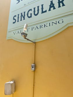

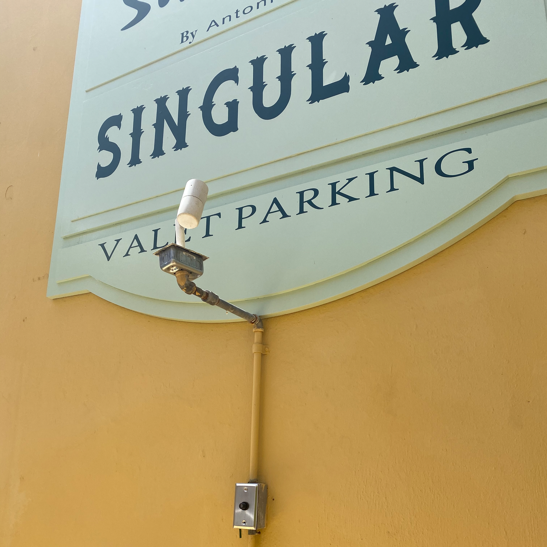

A Creative Wiring Solution
While this installation does show some creativity and imagination, using what appears to be gas piping or gas pipe fittings as a wiring method is not recognized by the Code. Section 110.8 informs us that only suitable wiring methods are included in the Code. There is no Article in Chapter 3 covering gas piping as a wiring method. The box installed for the luminaire is not suitable for this outdoor wet location and does not comply with the requirements of Sec. 314.15. Boxes installed in wet locations such as this must be listed for use in wet locations. The manner in which this box is supported does not comply with any of the provisions specified in Sec. 314.23(A) through (H). Section 314.23(F) Exception No. 2 provides very specific requirements for using one threaded intermediate metal conduit (IMC) or rigid metal conduit (RMC) for the support of a box, but this installation does not comply with those requirements. The cover on the lower box where the photocell is mounted is only secured to the box with one screw, does not provide a weatherproof enclosure, and allows moisture to enter the box. This loose cover does not comply with Sec. 314.15 either.
