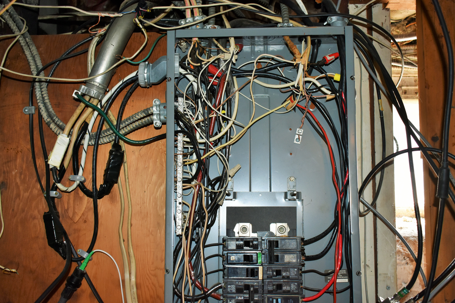

Worst panel change ever
Kevin Verga, an electrician for Perry Electrical Solutions in Peabody, Mass., spotted this catastrophe while working in a customer’s home. Whoever performed this panel change may want to consider changing professions because being a qualified electrician does not seem to be his or her calling. The service conductors installed outside of the raceway on the left side of the panel violate Sec. 300.3(A). Splicing these conductors in free air without using a box or other enclosure is a violation of Sec. 230.46 and Sec. 300.15. Section 300.10 requires the rigid metallic conduit (RMC) raceway to be mechanically secured to the panelboard enclosure. The back-fed, plug-in breaker installed in the top right panelboard position does not have any additional fastening means as required by Sec. 408.36(D). Most of the NM cables and AC cables are not properly secured within 12 in. of the cabinet as required by Sec. 334.30 and Sec. 320.30, respectively. A close look at the neutral terminal bar reveals at least one instance where more than one neutral conductor is terminated under the same screw, violating the requirements of Sec. 408.41. Lastly, I question whether the grounding lug in the upper right part of the enclosure complies with Sec. 250.8 requirements.
