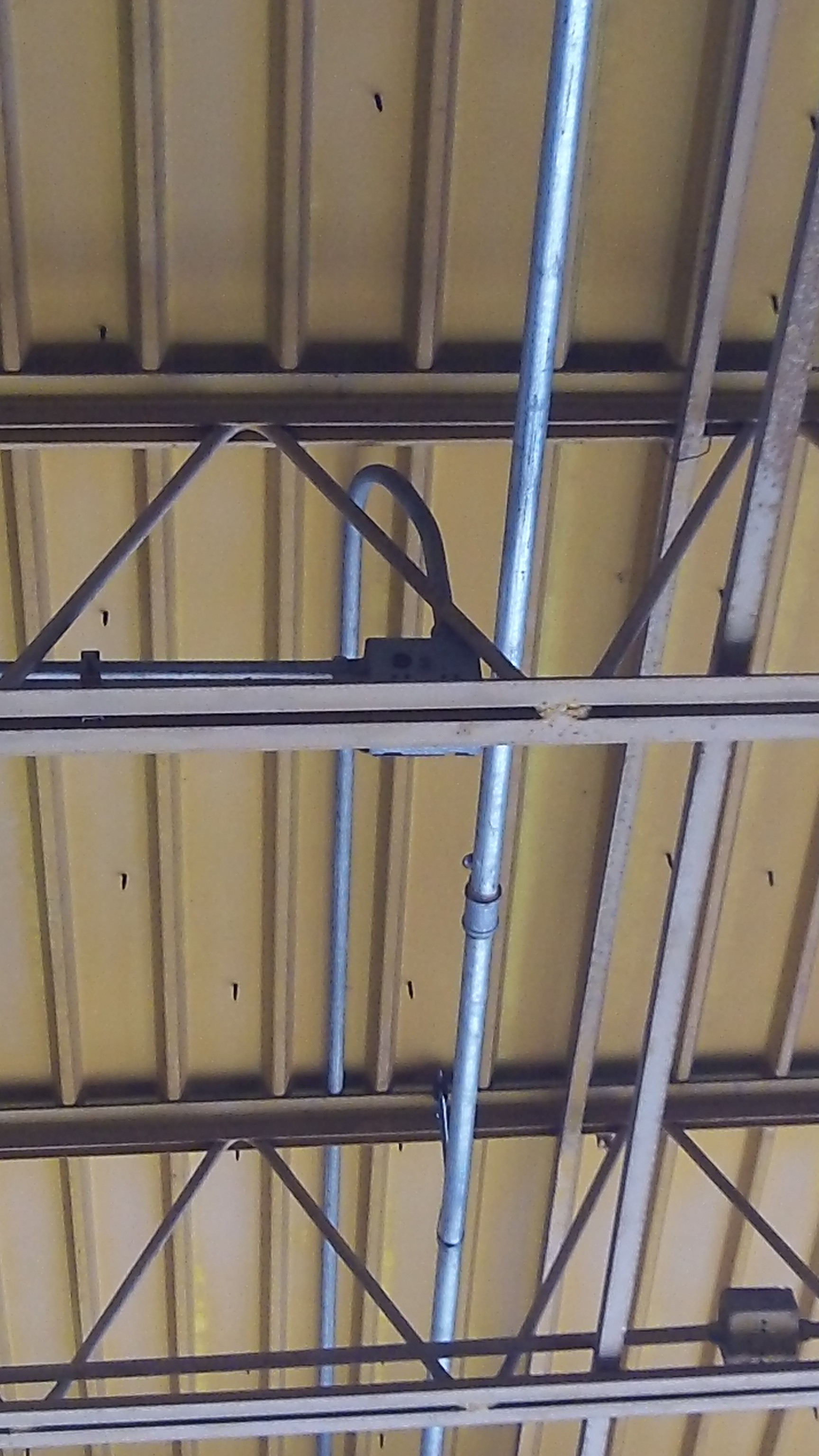

What’s Wrong Here? Hint: Roof Decking Raceway Run
Do you know how this installation violates the NEC? Hint: Roof decking raceway run
Feb. 5, 2020
Hint: roof decking raceway run
While running a raceway up above the truss work may be a quick and easy way to get the job done, sometimes it’s best to take your time and do the job right.
Section 300.4(E) requires raceways, cables, and boxes installed underneath metal-corrugated sheet roof decking to be installed no closer than 1½ in. from the lowest portion of the roof decking. The reason for this spacing can be seen in the Photo. Sheet metal screws used for making repairs to the roof, are poking down through the roof decking. When raceways are installed too close to the roof deck, these screws could wind up penetrating the raceway causing severe damage to the enclosed circuit conductors. Strut could be secured to the roof deck as a means of separating the raceway from the roof. Securing the raceway to the strut would then be permitted. Of course, there are many other ways to provide the required separation too.
