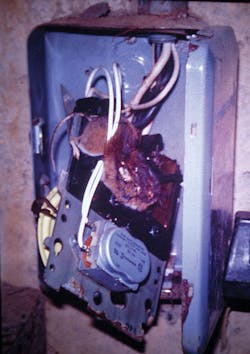

Hickory, Dickory, Dock...
This poor mouse had no idea of the danger lurking inside this time clock enclosure. I found him wedged behind the removable clock motor insert while I was on an emergency call troubleshooting the reason why some parking lot lights were not working. Needless to say, I found the problem.
The circuit breaker tripped when this poor guy came into contact with the energized contacts on the back of the time clock. He stood no chance of surviving. The reason he was able to get inside this enclosure was because one of the knockouts was missing and never closed up — a clear violation of the requirements of Sec. 110.12(A). It also created some safety concerns when the circuit breaker tripped, which plunged the busy parking lot into complete darkness. Thankfully, the presence of the mouse and the short circuit he caused did not lead to a worse situation, such as a fire caused by arcing and sparking.
In accordance with Sec. 110.12(B), I needed to replace the time clock because it was damaged. The installation of a simple and inexpensive knockout seal could have prevented this entire situation from happening in the first place.
