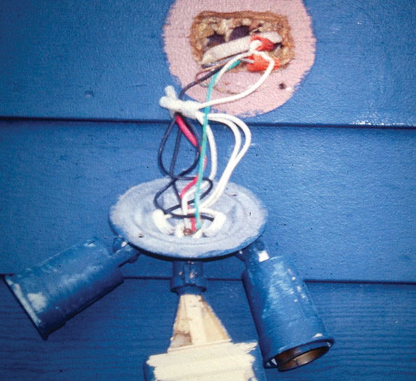

A Real Can of Worms
I discovered this problem when I tried to replace this motion sensor and floodlight fixture at a customer’s house. A simple job turned into a big can of worms when I discovered every outdoor fixture was installed without a box. The paint outline and the hole cut into the clapboard appear to indicate there may have been a recessed box at some point. Perhaps the installer couldn’t figure out how to match a round cover with a rectangular box so he simply screwed the round cover directly to the clapboard and stuffed the wires and splices into the wall. Whatever the reason, it created some Code violations and increased the risk of fire.
Section 300.15 requires a box to be installed at outlet points and when splices are made in non-metallic sheathed cable. Because splices are a weak link in the circuit, a box is needed in part to enclose the splices and prevent any arcs and sparks caused by loose connections from igniting the surrounding combustible wood. This installation also violates the intent of 410.23, which similarly requires combustible surfaces exposed behind a luminaire canopy or pan to be covered with a noncombustible material.
