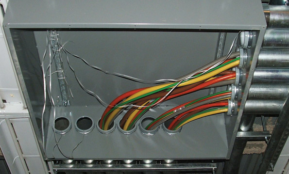

When sizing pull boxes for insulated conductors 4 AWG and larger, the dimensions for the pull box and spacing of the raceways are determined from the size of the raceways. For a straight pull, 314.28(A)(1) requires the box or conduit body length to be at least eight times the trade size of the largest raceway. For a box or conduit body where angle pulls are made (as was done in this installation) or where splices are made, the distance between each raceway entry and the opposite wall shall be at least six times the trade size of the largest raceway in any row. This measurement gets increased by the amount of the sum of the diameters of the other raceways in the same row on that wall. It’s possible to have the correct overall box dimensions but have the wrong pipe layout, since 314.28(A)(2) also requires raceways enclosing the same conductors to be separated by a dimension at least six times the trade size of the largest raceway. The 4-in. raceways enclosing the same conductors in this box should be separated by at least 24 in. The tape measure in the photo proves these pipes are too close together.
